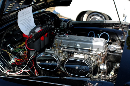

My street TR3 is equipped with Elgin cam with 280 duration and .427 lift @ valves (1.65 Cambridge roller rockers). It also has 10:1 compression, polished and ported head, dual Weber DCOEs and header. It idles at 1000 RPM. What is your duration and lift?

Sounds like a great setup. Can I ask, what are your carbs set to? venturi size, fuel stack buildup, air, emulsion tube, fuel, idle air and idle fuel? Doing some research. Friend's got problem with his, but he hasn't researched his cam, looks like we get to pull out the dial indicator and check it out.

Ron, just got back from a little traveling. I have all the Weber numbers written down -- I'll run to the garage to find them in a bit -- but the idle jets were drilled out by Bob Prouty (now deceased) in Milwaukee and I don't think I have the size recorded.
