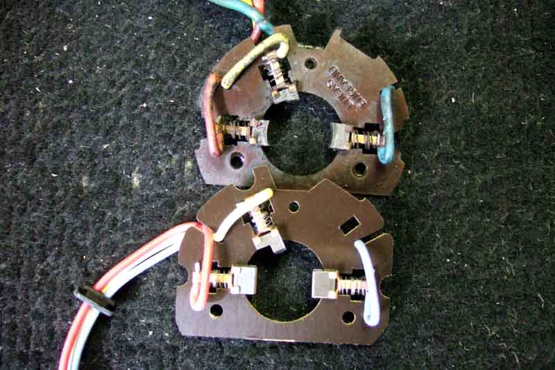

TraceZ
TraceZ
got it guys, thanks.
I'm going to clean the old grease out of the motor and replace it with new as well. The old grease was pretty bad.
TraceZ
TraceZ
Just completed a complete tear down / clean / repaint / refinish / reassemble on the wiper motor. It looks like new now and is packed with loads of fresh white lithium grease. The brushes on the motor were only slightly worn and the big nylon gear looked new. Overall great shape!
