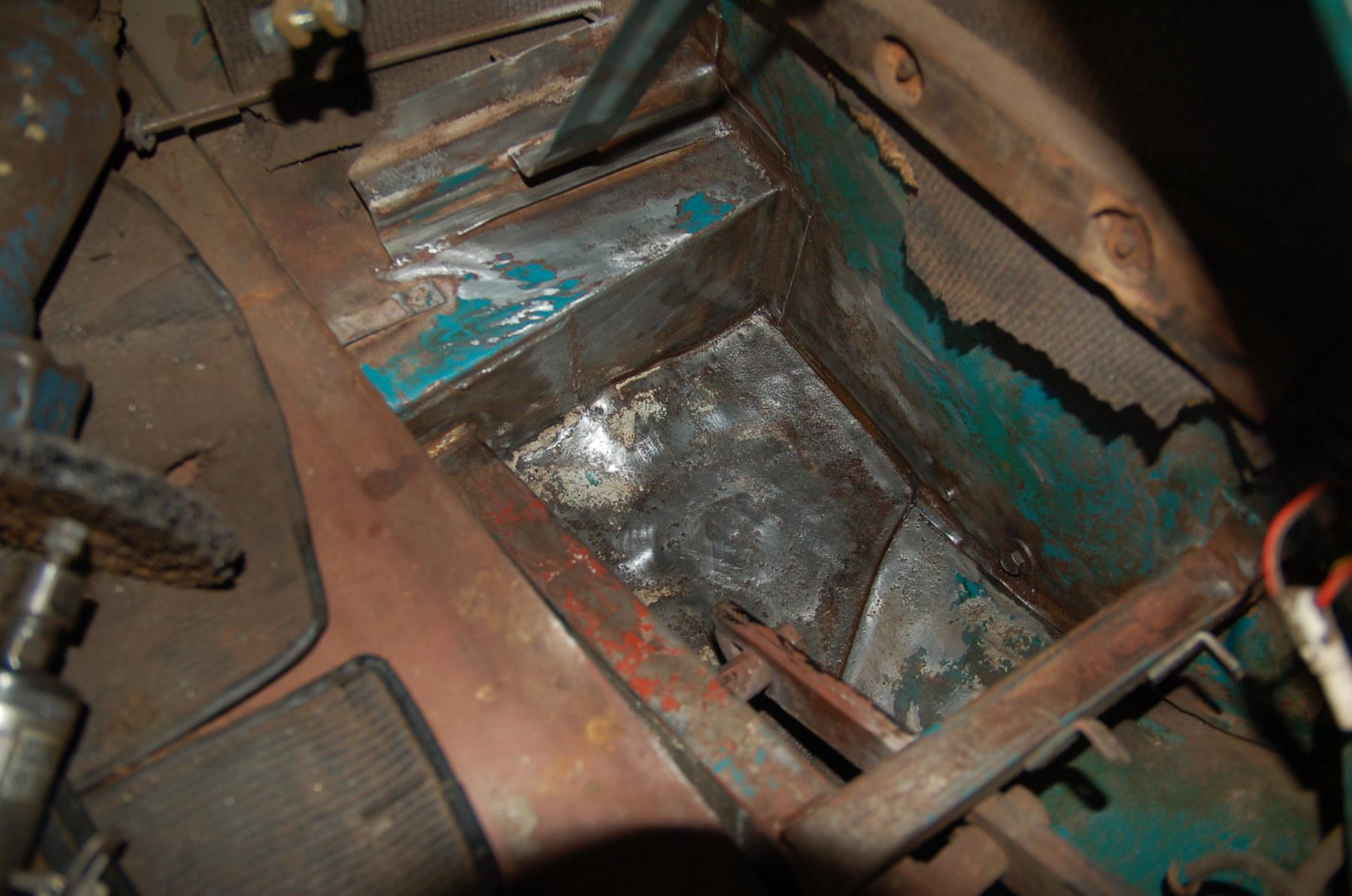

Hello @all,
I would like to share my horror trip below the battery...I found no Gold..
yes I found silver ....:jester::jester::jester:
Bye Michel-who found a silver mine..

i remember years ago when i bought an austin healey, the first thing i did was to remove the battery and dump a bucket of water mixed with soda into the rear compartment...usually resulted in a rather frothy mess of bubbles... rinse thoroughly with clean water and look for pin holes in the floor as well as in the gas tank...lots of folks did not pay much attention to the old lead-acid batteries and the potential for damage to the car.

Hello again,
@HealeyRick : I believe this is natural corrosion protection with positiv ground energy and acid rust converter..:highly_amused:
Without kidding , I expected nothing as a big hole and found raw material....
I know very well that it is normally a big patch area....for all vintage cars this is as well my experience that I agree with maxwedge5281
So and now I`m waiting for the world soccer cup today evening:cool:
When you get it repaired, it is a great place that I keep a spare fuel pump, solenoid, assorted small parts wrapped in water tight plastic.
