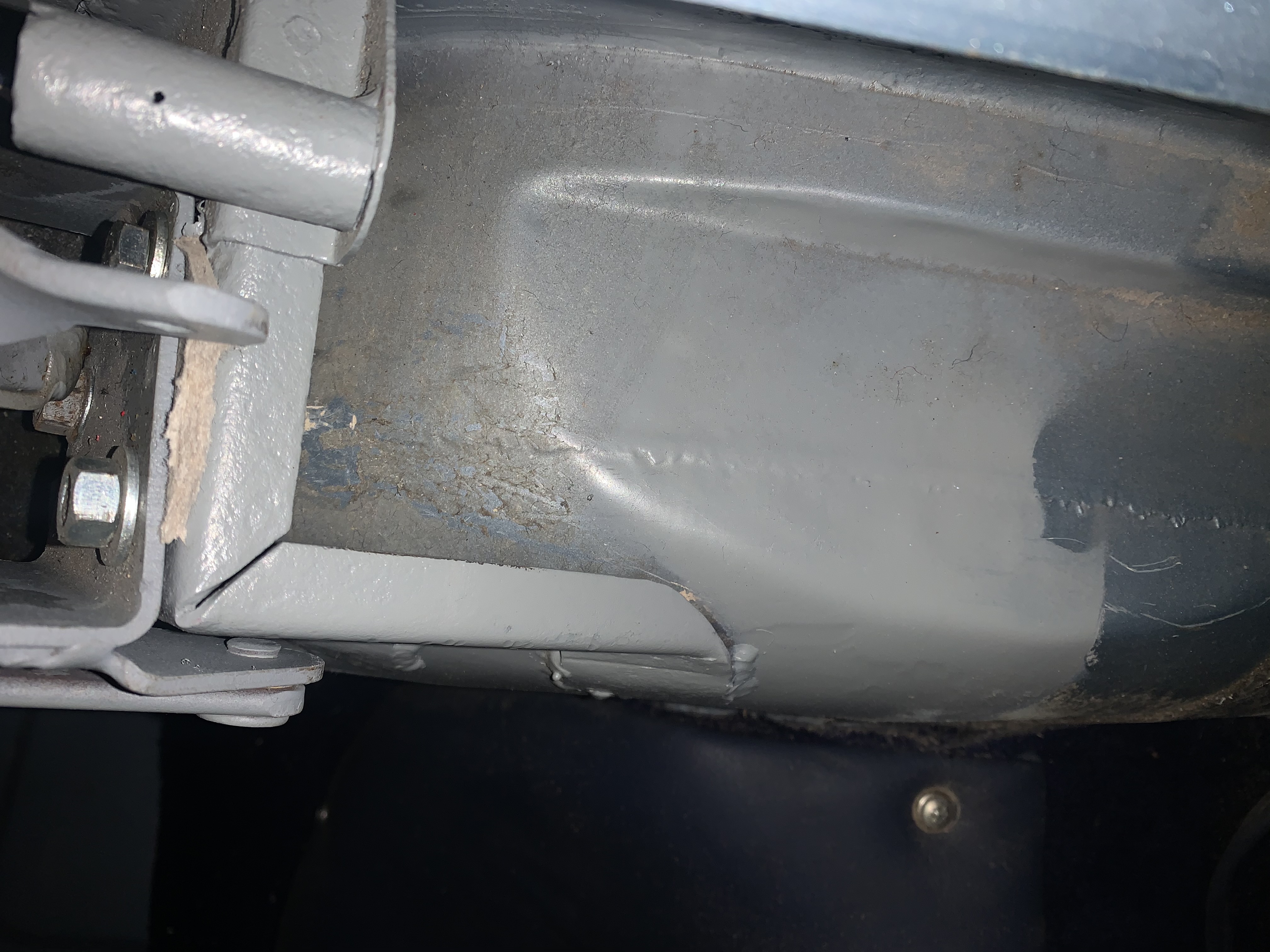

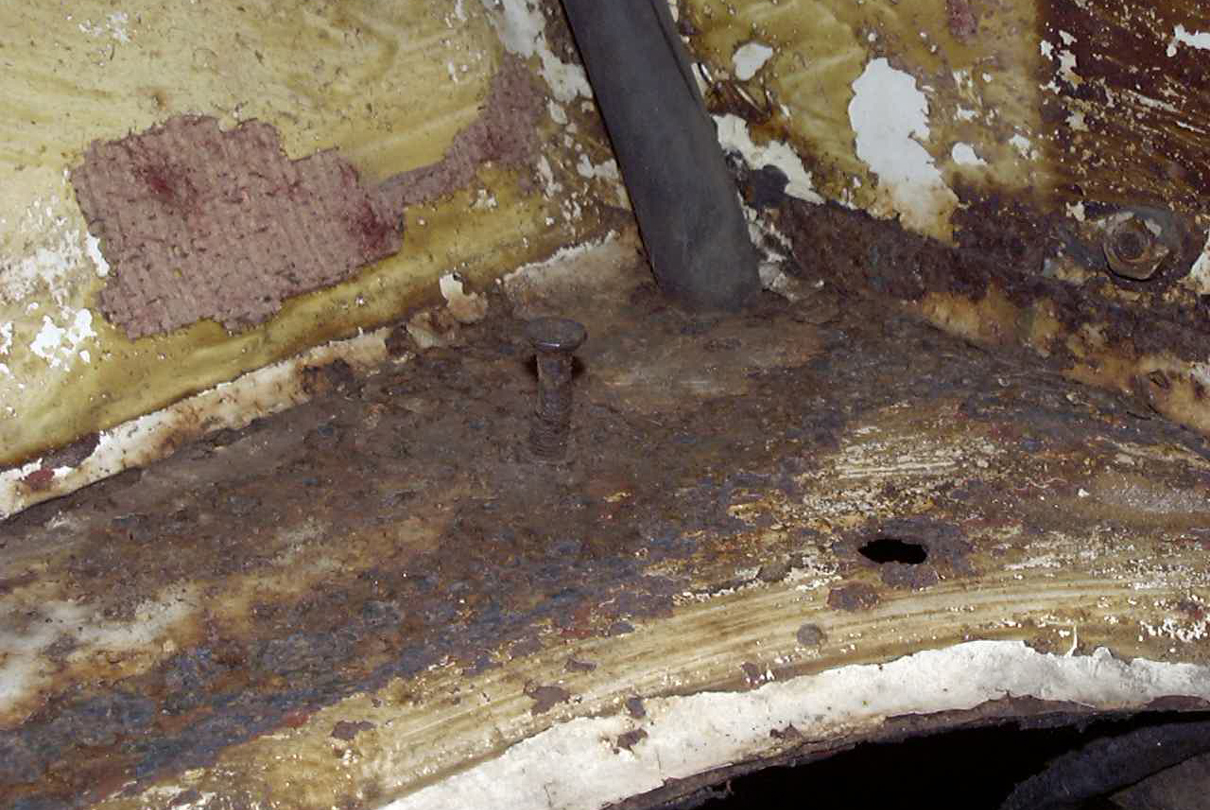

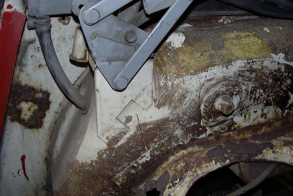

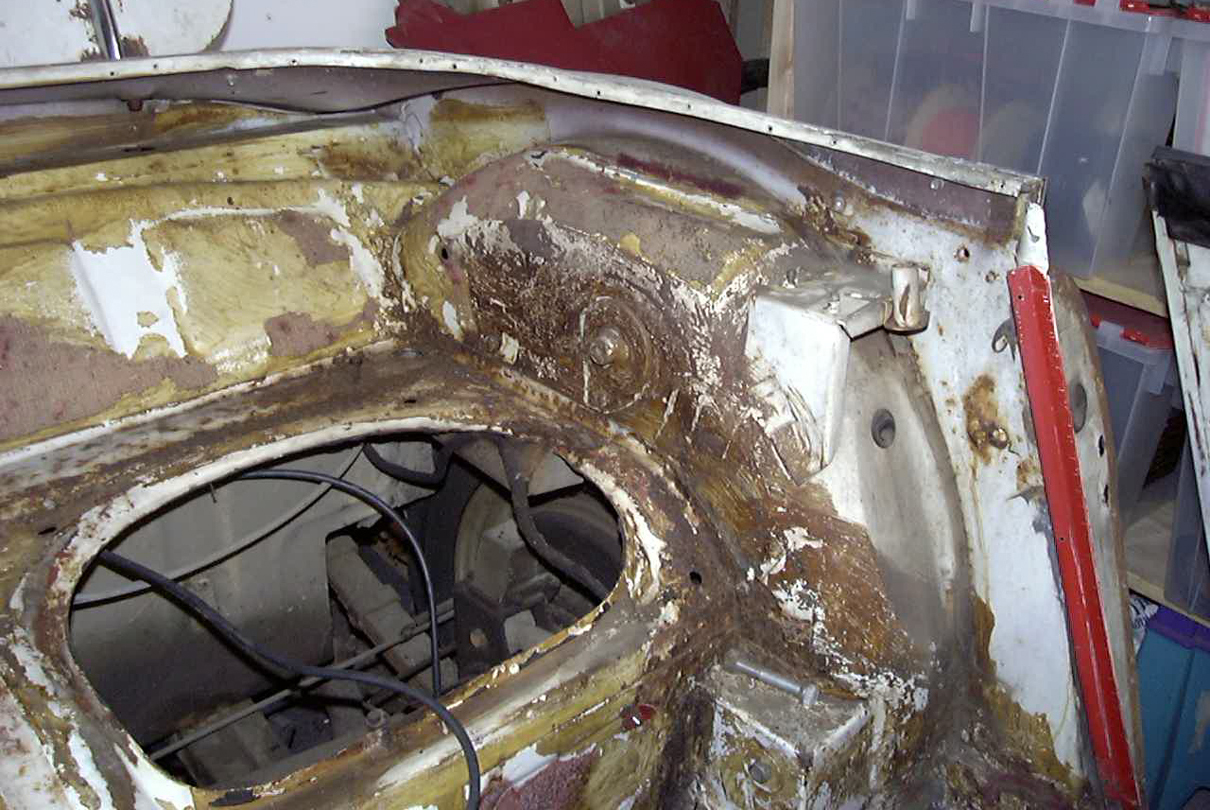

Here are some photos of my BJ8. The two hoses I don't have photos for are the center and passenger side of the seat surround. You should be able to figure their positions from the driver's side shot. It looks like there was only grommets for the wheel wells?
View attachment 68617View attachment 68618View attachment 68619
Greg, thats great thanks. I fitted a new rear panel and believe that has the holes in place already, it was the wheel arch ones that were throwing me. Rob
