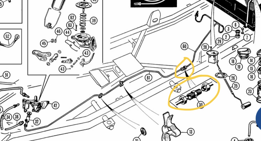

Hamish,
The early TRs did have a compression fitting in that rear location. Then at some point it was changed to just a rubber fuel line.

It is crucial to NEVER use regular fuel hose in this spot.Only fuel injection rated hoses
will stand up to modern fuels and not degrade in a short time. They swell shut!!!!

In fact when putting that connection in I found that it best to push the two metal pipe ends into the hose to where they touched each other.
