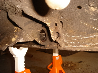

Hey guys, I got to work on my '61 BE for the first time in a long while. I got the front end stripped but ran into a bit of a problem. The LH spring pan came right off with no problems. However, when I got to the right side, the rear trunion bolt wouldn't come out so I wacked it a few times with a BFH and unfortunately, damaged the front hole (see photo). I figured out later that the metal bushing liners had siezed onto the bolt and made it oversized. I'm hoping that when I get the shell back from the soda blaster that I will be able to flatten this back out and weld it up... thoughts?
Also, after much consideration, I'm thinking that I will take it to a pro Soda Blaster rather than buying the Eastwood system. I'm hoping they will do a better job and that will help speed up my resto. Also, blasting is messy and time consuiming work. Thoughts?
Today, I'm planning on dropping the rear end. I've never worked with a 1/4 elip, rear end so any hints or tips will be appreciated. Also, I would like to get the windshield off, but the bolts seems frozen in place. I can get PB Blaster on the ones closest to the cockpit, but I can't see to get to the underside of the front ones. Any tips? I was thinking about putting a screwdriver tip on my impact wrench!

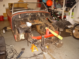

Here's a photo of me test fitting the rotissary on the front half of the stripped bay. FUN! lol!

WOW! Looks like you're doing a heck of a job! I recently heard of soda blating vs. Sand blasting...gotta read up on the difference..maybe I'll make a post of it!

Soda Blasting is much easier on the panels and supposably doesn't warp them, but it doesn't remove rust. For that you need sand or another media.

If the rear spring hangers are REALLY rusted then you might want to go ahead and cut them out and sand blast everything so you can find some solid metal to work from.

I'm talking about cutting out the complete spring hanger section. Give some good hard jabs around the area and see how solid it is. I'd hate for you to spend a weekend trying to get those springs out and then discover that the metal all around it is paper thin.

I'll definitely poke around the spring boxes with a screw driver. wish me luck! I would hate to have to replace those suckers. But nothing would suprise me with this car.
