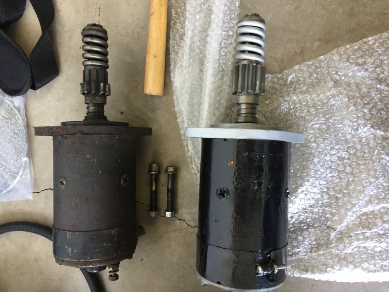

HighAltitudeTR3
I had the wrong starter issue. Locked up the entire engine. The starter was actually fine, I ended up using it. But the gear on the end was wrong. It would hit the bolts on the fly wheel. I ordered it from Victoria British and they had no idea what they had shipped or that there was a difference. I pulled the gear off the old one and it worked fine.
HighAltitudeTR3
Look at the teeth on the gears. Simple swap.
sp53
Well great-- a simple fix, did it damage the ring gear? Probably not because of the onetime deal, which one did you end up using, the left or the right in the picture. I am curious because it could happen to me. The old one on the left looks correct, but it looks like they both should work. Perhaps the amount of teeth was the problem.
steve
HighAltitudeTR3
Steve it didn't cause damage, but it freaked me out for a couple hours. I thought the engine had seized. But I took off the starter and back to normal immediately. The worst part of the experience is Victoria British didn't see that they did anything wrong!! I won't order from them again.
I used the gear from the starter on left, it was a simple swap.The gear from the starter gets hung up on the bolts on the flywheel. I believe there are only a few years they had the bolts like that.
