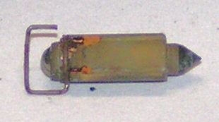

if anyone had seen (on any cars) something I remembered from my youth. Some car I worked on had a music wire clip that secured the moving needle of the float valve to the float arm. When the float fell the clip pulled the needle off its seat. The clip was still loose enough to allow free motion of the needle in normal operation.
you mean like this?
you mean like this?
These clips are pretty much standard on Japanese motorcycle carbs. Mainly because of the very low (1/2 psi) fuel pressure that is normal on gravity feed carbs. I have found that SU's & such do not feed reliably with very low fuel pressures. Less than 2 to 2 1/2 psi. The needle, seat, & float need to operate very smoothly & friction free to feed at low pressures.
OTOH, pressures much above 3 psi will cause the opposite problem. Not much room for error.
