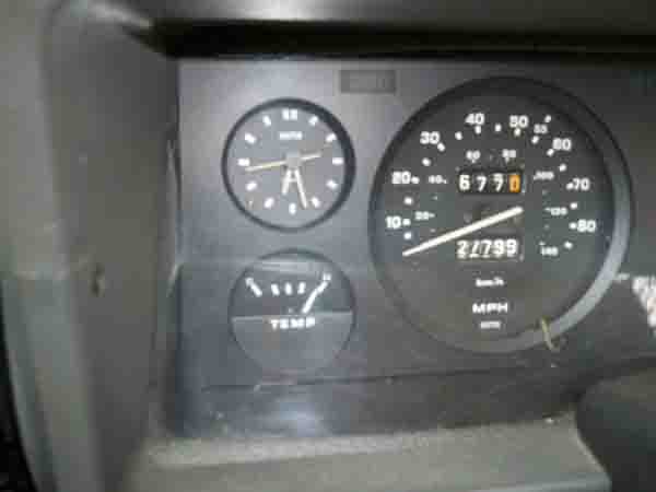

Here are the pics. I drove the car today. The first pic is of the temp gauge after 13 miles. As you can see the needle is just off the H line. After 5 miles it was just a tick past the 3/4 mark. This is a 67 degree day too. However there wasn't any indication that the engine was overheating. Head gasket or warped head has come up in conversations but I did not notice any temperature fluctuations that you normally get with a leaky head gasket. Also did not notice that "heat smell" or feel a blast of heat coming off the engine once the hood was opened. The tech may be right that the gauge may be off. I'm thinking maybe dirty radiator from not being driven much. 27k on it. Maybe a good flushing is in order but then I would have noticed the increase in heat.

One idea is one of those not contact thermomters. not expensive and could solve the issue of the gauge or engine. I would want to know before I would put out the money.

I agree, hit the engine w/ an IR thermometer......

I do have a IR thermometer but forgot to bring it. What should the block temp read? I can always go back. Is the $2500 fair?

I forget where the temp sending unit is on a TR7. It is either on the intake manifold somewhere or it is the one on the L/H side of the radiator near the top. Shoot the IR thermometer at it and see what you get. Obviously that is the point it should be reading. If it is 195ish, you should be good. In fact just shoot the return side of the radiator...if it is over 210, there are issues.
Bad sending units, bad gauges, etc etc etc can give false readings.
I pulled my dash apart on my 8 to fix the clock. Along the way I bumped the needle on the temp gauge. I had the coolest running TR8 in the world as I never got over 1/4 :smile: I have since "recalibrated" :smile:

The sending unit is on the thermotat housing. I have always seen the sending units "open", that would give a zero reading on the temp gauge. It would have to "short" to give a high reading. I'm not saying it can't happen, just have not seen it(yet). As far as 2500, I have seen a few go that high but it would have to be a totally maintained car. Every piece of rubber on that car is bad or going bad if it has not been changed. Some are no big deal,some are. As a quick check just lift up on the shifter. if it has play, it needs bushings(Very common). I'm going through my 7 and its a long process to try and do everything at once. I'm doing a little at a time.

The temp issue could be as simple as a bad radiator cap. If the system can't build any pressure it will boil, and the temp gauge will peg. usually will be fine idling, or around town, but any higher speeds will cause the temp to rise.
More likely is a bad thermostat
