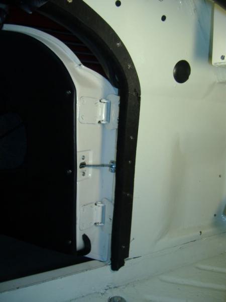

I was wondering if this car belongs to one of the forum guys. I ask because I wanted to know what the stuff the windlace is held on to, the black backer board.

In my TR3A it was like a very thick cardboard. My Skinner kit for the TR2 came with 1/4” plywood as a backer. It also holds the edge of the carpet too, although that’s not shown in the pic.

Thanks John that is kinda where I am at, I cut some out of the same stuff I made the door panels with, which is a heavy card board pressed paper wood something. The original stuff at the door edge is like tar paper pressed board about a ÂĽ inch thick which would repel water. I liked that because we get sooooo much rain here and that area is at a water shed point.
I went up to HD and they had some synthetic flooring ÂĽ thick that would have been water proof, but I needed to buy a whole package plus there was not enough room to make the full arc because it was not wide enough. I am going try and paint the pressed board, but I doubt the paint will stick well maybe a stain would work better.

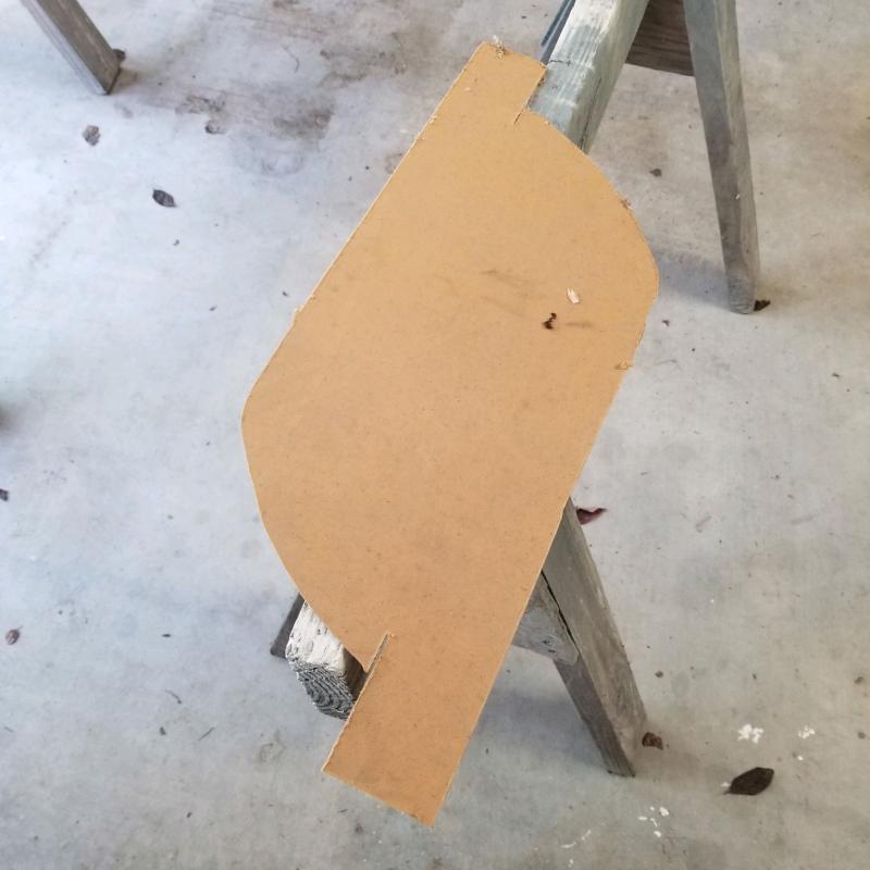

My Skinner kit came with just a length of the fuzzy trim and no backing. I cut 2 pieces of Big Box store Hardboard to match the "A" post profile about 3" wide and going up behind the dash.
As far as I remember I glued and stapled the Fuzzy trim to the body side of the Hardboard then held it in place with several screws. The carpet was glued to the hardboard and had a few screws with cup washers to make sure the carpet stayed in place.

Well that sounds like what I have planned also David. I can see the image; it is not too difficult. This time I will use some staples myself also because the last time the glue gave out after a couple of years.
