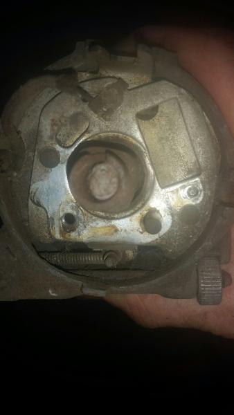

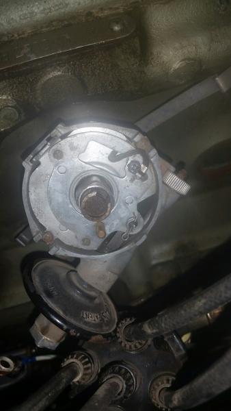

I was in the process of installing a Pertronix ignition module in my BN2 and ran into a problem. The location of the post on the breaker plate does not allow installation of the Pertroninx module. The junk distributor I have on the shelf is a DM2 that has a different breaker plate and if it were in on the engine it would accept the Petronix module. So the question is, what do I have on the engine? More important to me is that this distributor is in good shape and has been problem free, I don't really want to change it. I've added some photos to show what I'm talking about. As usual I expect that the vendor I bought it from is not going to exchange it with me unless they are comfy that since I couldn't install it I didn't ever put power on it (I'm waiting to hear). I'd like to figure out what I have and order the correct Pertronix part. My installed distributor stamped data has the part number 40495A, which goes back to a DM2P4 as does the one on my shelf. Has anyone else run into this? The photo on the left is on the engine and the one on the right is showing the breaker plate I would need to use the Pertronix unit I ordered. Thanks.

I have never answered my own post and I'm not sure it will work but does anyone know if I just need to swap out the breaker plate with the one I have on the shelf. That would make me happy and you'd all hear a big forehead slap.

So, I got my question about the distributor answered and some of you probably already know this but there were two styles of 4 cylinder DM2P4 Lucas distributor. An early style with 2 piece contact breakers and a late style with one piece. They have different breaker plates and the vacuum advance connection to the breaker plate is different between them. This info is actually on the Pertronix application guide. I'll be getting the correct Pertronix unit soon. I did speak to a Pertronix rep about this and he did in fact say that although it might work just fine and last a long time, they no longer recommend using any of their Ignitor trigger units with copper wires. That having been said, they have not changed their application guide one iota. I'm willing to take the chance (thank you Keoke and Steve). If I can do it without too much ugliness I just might shield my wires with some braided stainless tubular shielding I happen to have a bunch of. At the least I'll put in some new copper wires because aged, work hardened copper aggravates the Rf issue.
