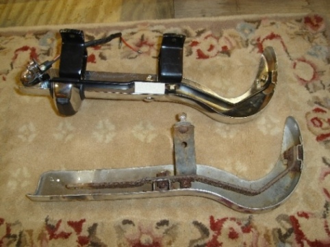

dfwip
Hi Jer-
Reference the attached photo.
Look closely.
The top bumper is from a '74.
The bottom bumper is a pre-'74.
So long as you keep EVERYTHING else the same, you can
simply swap the overrides.
Problems start if you mix and match (which I tried...).
You will see the pre-'74 has a mount in the bumper center
that the '74 does not have. You will also see that the
brackets that mount to the car on the '74 are heavier than
the pre-'74. I learned most of this stuff the hard way,
as I tried to mix and match the best pieces from my parts
collection...not a good idea. Note I also switched to the
pre-'74 style license plate lights.
Similar caution applies to the front, as the integrated
chrome "mounts" are different as well. I can provide details
on the front if same is needed.
Hope this makes sense...
Paul

Did the swap this weekend, I now see what you mean about it working as long as you don't mix & match, basically I just took the old rubber mounts off & direct bolted the new overriders in their place, the 3/8 NF x 2" that I ordered were 1/2" short (maybe okay for a pre 74 bumper), so I went to hardware store, got some 2 1/2" long bolts & snugged the new overidders on. The chrome on my bumpers is shot but the bank account only allows for overidders this year :smile:
