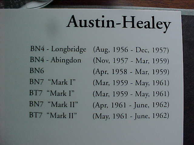

bighealeysource, colorado red..mfg.code-rd.02, ici.code-3742. at mfg. plant and dates thus illustrated, from the book, austin healey, guide to historic colors models 100, 100-6, 3000, sprite, by donald pikovnik. :savewave:

timk, it seems the flame red was used on "sprites" heres how it is explained in the book,..HAN-10.sept,1969-dec,1970, AAN.-jan-july,1971., big healey reds include carmine red,rd13,ici2260,..carmen red,rd13,ici8616, reno red rd14,ici3000, colorado red rd02,ici3742. i do not know what "HAN" or "AAN" indicates.
