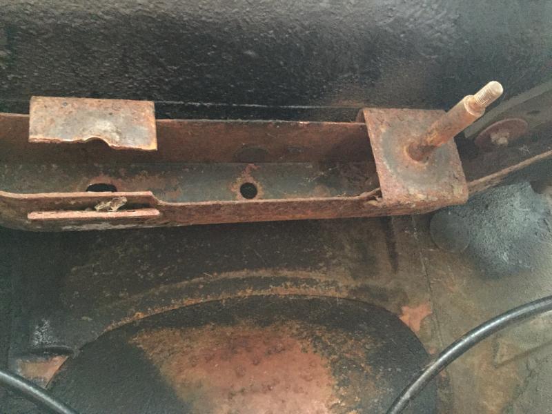

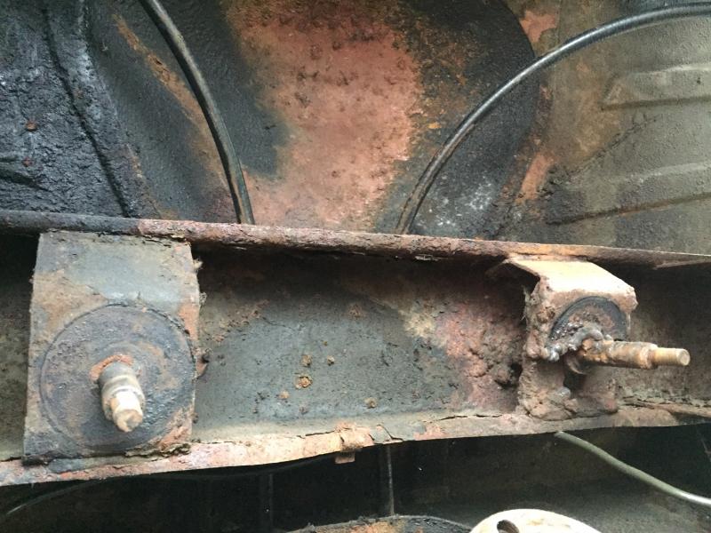

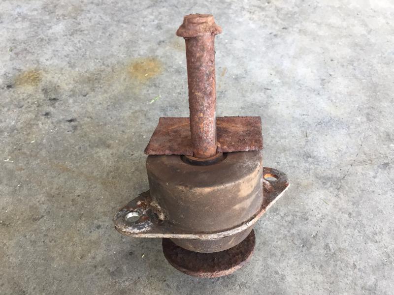

This took me a while to work on. The car was in storage for 15 year before I bought it. It had not been drivable til now because of non existent brakes and then a realtor bad misfire. Finally got the car running well and with the most perfect,top-down weather I could not resist some drive time even with the obnoxious chirp on acceleration. I'm really old enough to know better..... This morning a feeling of impending doom came over me as I down shifted for a tight turn on a beautiful curvy country road. So I called the ride short a headed for home to check out the u-joints. After pulling the half shaft and check the joints,they were fine. On to the differential mounts........ Take I look.... I think I found the cause of the noise...
attachment.php
attachment.php
Nice workmanship, right?

I haven't had mine welded yet, so I haven't seen it without the mount installed, but I think my passenger front is a twin for the middle picture
M_Pied_Lourd
Pretty Nasty looking...
