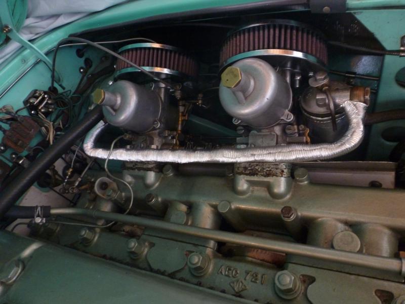

dancrim-I had a similar issue with stumbling acceleration especially after stopping at the end of freeway ramps and taking off from that point. I think I have solved the issue by using a cozy like device fitted over the SU Carb bowls sold by Joe Curto called "Koolmat Koozie". This when combined with a thermal wrap on the carb interconnecting fuel line by Thermo-Tec (17075 3/4" X 36"). Seems to work so far. See image attached. Peter. Cozy.jpg
