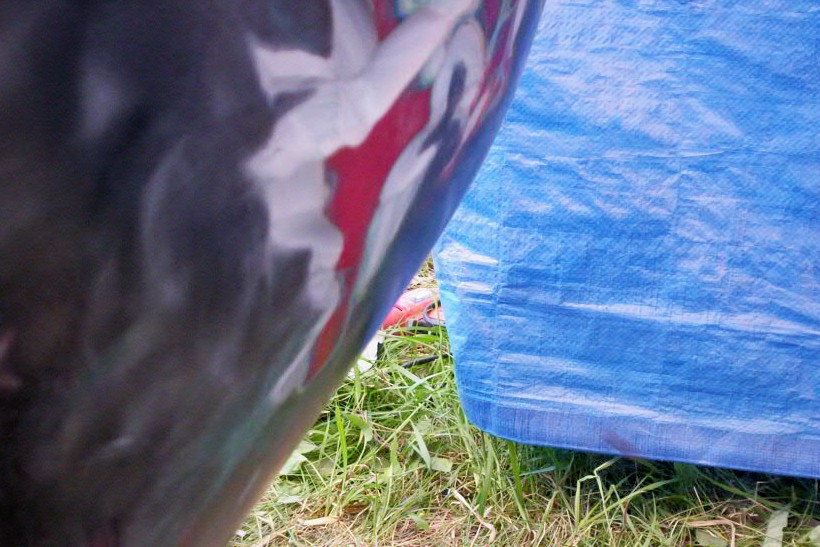

While waiting for my blasting pot to become available I decided to begin the process of stripping the car using my angle grinder and a wire wheel. Works real well. I now know that the car has had 5 different colors of paint applied over the years; Original Signal Red, White, Inca Yellow, some strange Royal Blue Metallic, and the orangish red that was on it when I bought it. Each layer is accompanied with it own layers of primer and bondo.
I flipped the frame rightside up, set the body on it and started grinding. I found that some VDPO had used Bondo in thicknesses up to 3/4" to fill in minor dents and dings. There is bondo 1/8 to 1/4" thick in places where the panel is perfect. ????? What gives? Here are a couple of examples.

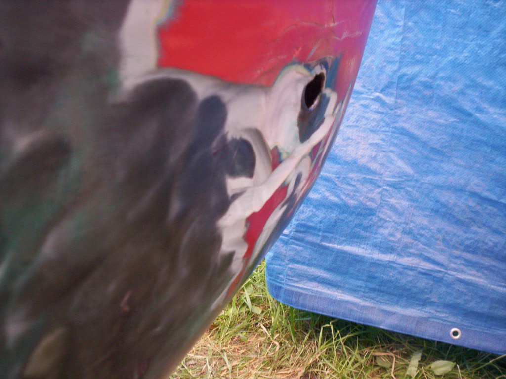

And another. The sad part is that where the bondo is thickest the panels are the smoothest. Most of the thick bondo is in "oil can" dents that I have been able to remove with gentle hand pressure or minimal hammer and dolly work. I think I have my work cut out for me. I have also found some original factory lead work in small areas.

For sure Paul. I think I have ground out a couple hundred pounds of bondo so far and I still have a ways to go.

[ QUOTE ]
[/ QUOTE ]That sort of thing never ceases to amaze me! I had the same thing on the second Herald I ever owned (originally bought as a parts car after I crashed the first Herald...but the "parts car" has survived and is being restored eventually...but I digress). The most amazing thing is that someone apparently took the time to remove the front parking lamp assembly...in order to lay in about 1/2" of Bondo in that area. Ironically, it's very easy to get at that area either through the hole where the lamp fits or by getting behind it. While only 17 at the time, I'd been taught well by a few "old timers"; I removed the Bondo, did a little hammer work, used a very small amount of Bondo for smoothing (even managed to preserve the seam), and painted. Still looks fairly decent 36 years later!
Of course, with 39hp, no Herald needs any extra weight. In addition to that parking lamp area, I must have removed 10 lbs. of filler from the rest of the bonnet as well!

I agee. A little body filler can be a good thing. No sane person will spend the time to get every panel perfectly straight with hammer and dolly. (If that is even possible.) What I can't understand is the gobs of this stuff where there is no metal damage. It is like they couldn't get the door to line up so they started layin on the bondo til everything matched up.
