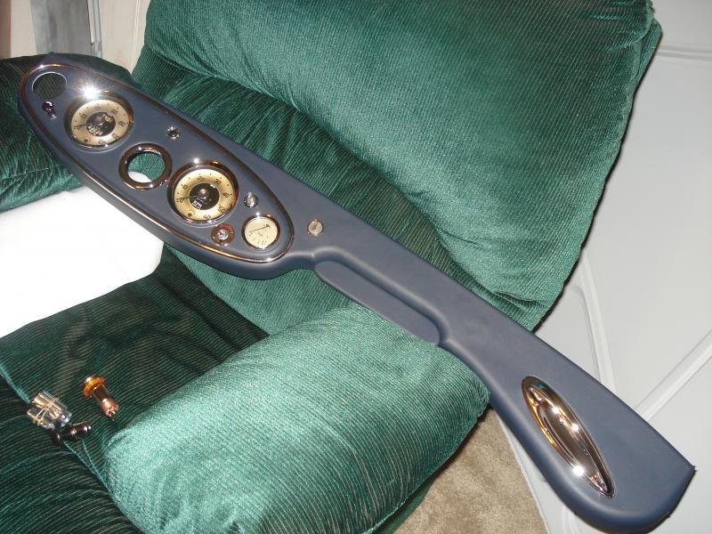

John Turney
The dash is covered in unpadded vinyl, the same color as the interior, including the dash pad. Moss includes a roll of the vinyl that covers the dash pad with the interior kits.

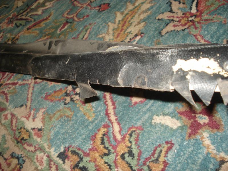

On the early 100/6 cars there was furflex along the bottom of the dash panel, and on the BJ8 the top pad was black on all cars. As per "Anderson & Moment". Bye the way, their 'restoration guide' is an excellent read.

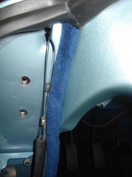

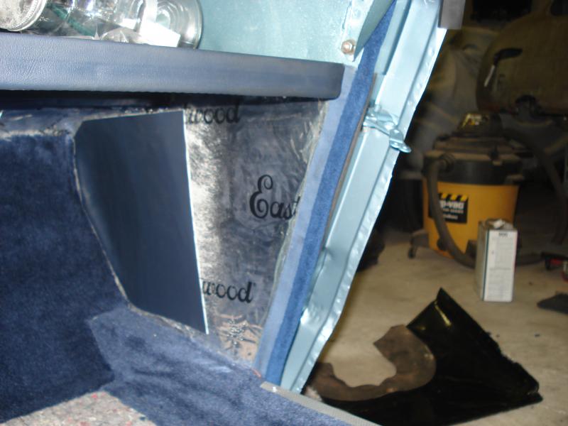

healeyblue
The longbridge cars should not have furflex running the length of the dash. There are only half moon shaped clips that help secure the dash vinyl. Disregard the heater delete panel as you will most likely have the heater controls in that area.

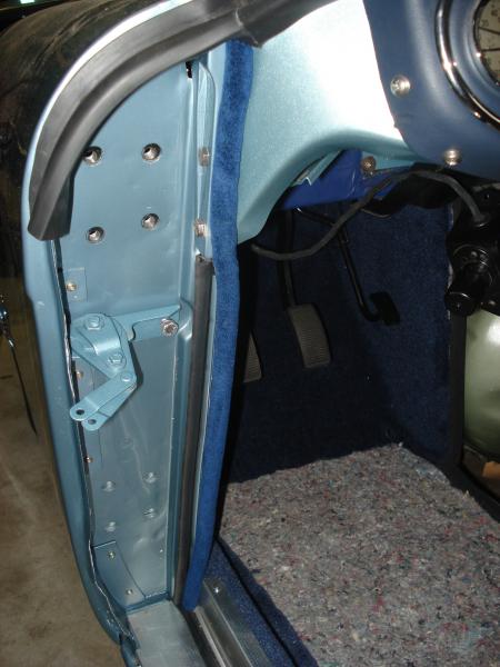

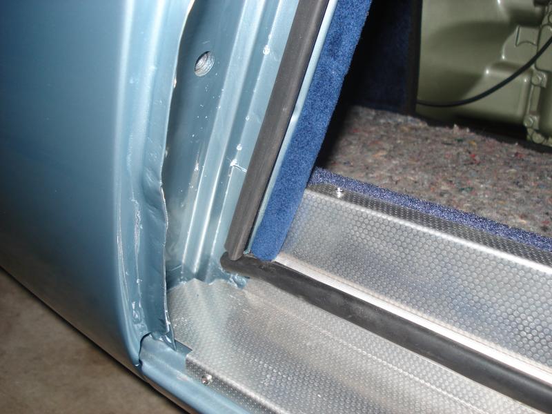

healeyblue
The length of furflex you bought (if it is not the pinch weld style) will get used on the front edge of the door opening running behind the rubber weatherstripping.

healeyblue, Is your car a Longbridge 100-6? If so, does that mean that they had furflex on the front door posts? That would be good news, as I could use up some of that red furflex that I bought.
healeyblue
Yes a longbridge car. Thats why I have been posting. Trying to steer you straight on some of these longbridge only issues. I just scored a correct set of side curtains too!! This car will be very close to correct soon.

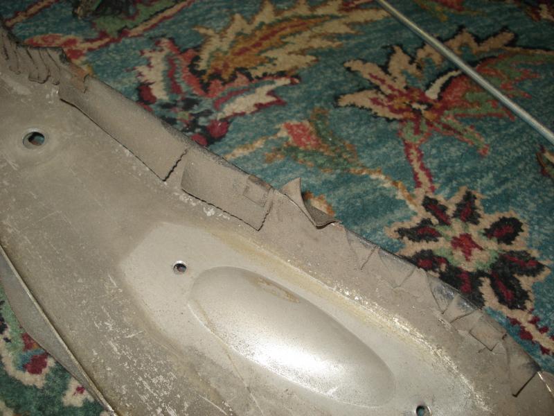

healey106
What was the build date of your Longbridge BN4? My Longbridge was built in April 57, another birthday coming up soon at the end of the month. I could you a photo of the original red vinyl dash which was later painted black by a prior owner, but it shows you exactly the placement of the upholstery "D" clips used at the bottom of the dash

blueskies
healey106, It has a build date of February 6, 1957 - that makes it 58 yr of age. And thank you for the offer; I would like to see those photos.
oxford
Blueskies
I applied the cement to the dash, the edges and the reverse face of the vinyl. I used the smelly and effective spray stuff, full of nasty chemicals, not the wTer based one.
