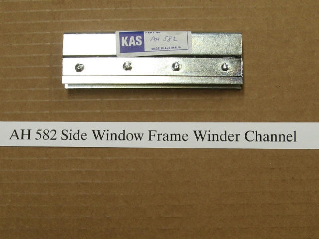

I am just in the process of fitting the frame to my windows on my BJ7 . The window channel is not attached and I need to know its position on the bottom frame. Attached is the channel in question.
Many thanks
Greg
vette
If my memory is near correct, this piece has some adjustability to it. It is tapped unto the bottom metal frame of the window glass. put the window either all the way up or all the way down and see where the arm and this pieces meets it. this piece can be moved horizontally somewhat to get perfect actuation of the glass. the object is to get the window to travel its complete travel without the sliding arm coming free of this piece. May be some trial and error to get it right.
