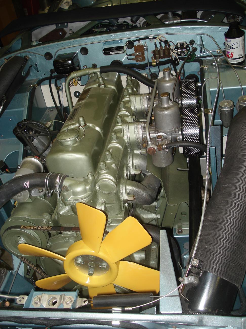

I had to make mine as well (the pivot side) and it wasn't very hard at all. Here you can see the spring side. The spring goes into a hole on the radiator support bracket.

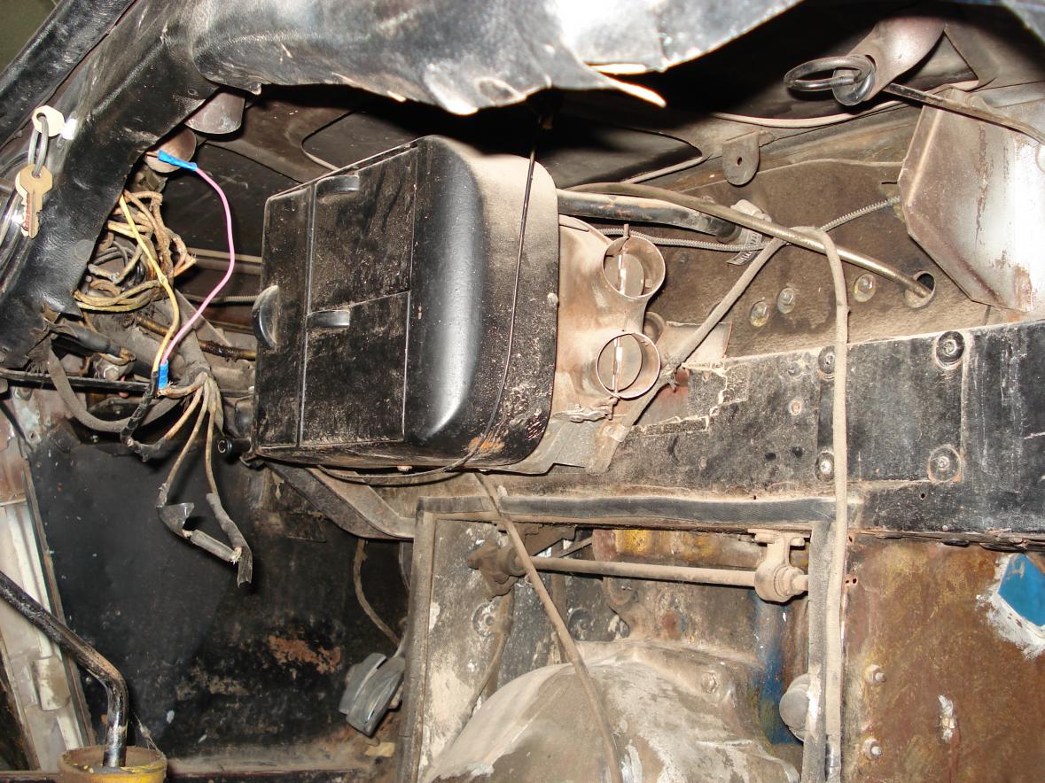

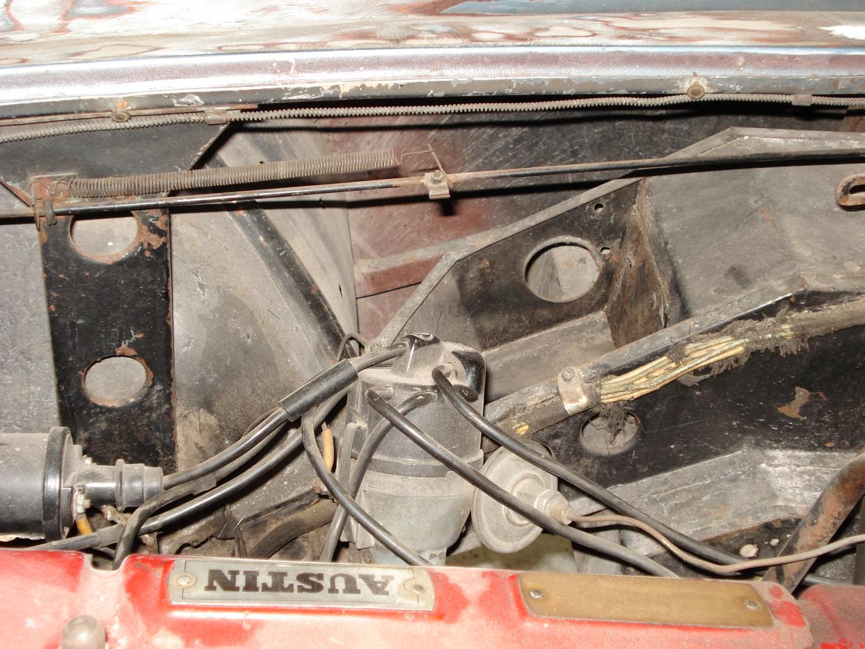

The middle support is just a simple angle bracket for a grommet to prevent rattling. It is secured to the shroud support with one of the screws. The one inside the car is a bracket that is spot welded to the underside of the cowl and bent (twisted) to the proper angle for support.

thanks for the picture. im in luck...just checked beneath the dash and the bracket for the pull is still in place beneath the shroud. it was partially covered by the heater ducting hose.. thanks again.
