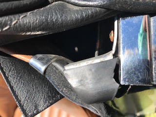

I think I found a way to reduce the size of the attachment to meet the BCF size requirements. I do not remember who sent me these instructions, but they are very helpful. I think I also have pictures of the clip that attaches the Bristleflex to the rear panel edge.
  • Bristleflex Instructions.pdf
John Kuzman
Here are a couple of pictures taken at a recent show.
bob hughes
Yup John
That is what I have done with mine too, I might have taken mine a bit further along the inner quarter panels.
:cheers:
Bob
RAC68
Hi Rick,
I also added an additional trim-collored screw about 5" below the one described in John's MacGregor document to assure tight active-side placement retention of the weather strip during consecutive door closes.
Ray(64BJ8P1)
