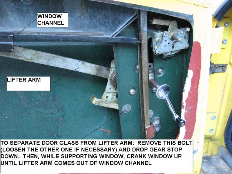

The way to remove the window frame from the door is to remove one of the bolts from the window stop (an L-shaped piece of metal that stops the window regulator gear) and loosen the other one so that the stop can be swung out of the way of the gear. Crank the window up until the spring-loaded conical slide on the end of the lifting arm can be removed from the channel on the bottom of the frame.
The window frame can then be lifted up out of the door. Reinstalling the new glass and frame is a bit of trial and error to get the glass exactly the right height to be able to fit the spring-loaded slide back into the channel.
I think you are correct that the frame is sticking because there is no glass in it to stiffen the assembly.

Steve thanks very much for the photo if I undo the bolts as you suggest will I just get the window channel or or will the side channel`s come out as well?

David, when you pull the window frame up out of the door, the front and rear channels that it slides in will not come with it. The front channel is the rear of the vent window frame, which is bolted to the door. The rear channel is also bolted to the rear of the door. Oh, yeah: you also have to remove the rubber tip at the top of the vent window frame.
I really don't think you can very easily install a new glass with the frame in the door. The bolts I referred to only attach the regulator gear stop. You just need to swing the stop out of the way in order to crank the window up high enough to disengage the lifting arm from the window frame channel (it comes out of the front of the channel). It's actually pretty easy to remove the frame to install the glass and therefore not worth the effort to try to leave it in place.

Bob, I wasn't saying the regulator had to be removed. The stop that limits the travel of the gear and lifting arm has to be swung out of the way of the regulator gear so that the window glass and frame can be cranked up high enough to take the lifting arm out of the glass channel. The glass and frame can then be lifted out of the door. See the photo attachment with my post above. I didn't label the gear stop, but it's the L-shaped piece of metal you can see in the photo.

Steve I didn't understand why I needed to remove to the window stop as I had not done so when I took the channel out (no glass of course) but then I did as I came to reinstall,otherwise there would have been no way to locate the riser, so thanks.
