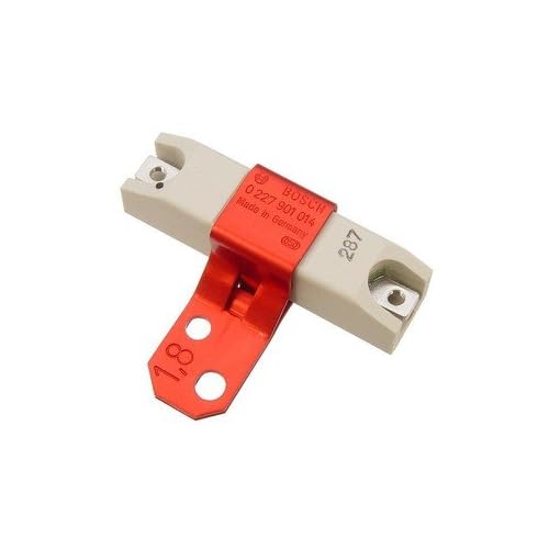

Thanks Mike. Here's the resistor:
Note it's marked 1.8. I just tested it again (removed from car) and it still shows 5 ohms.
So the engine was trying to fire on 5 volts. When I removed the resistor from the system, engine fired immediately. But with no ballast, points are going to fry eventually.

DNK
Sounds like you might want to throw one at it if it's cheap enough Tom.
Are they expensive?
