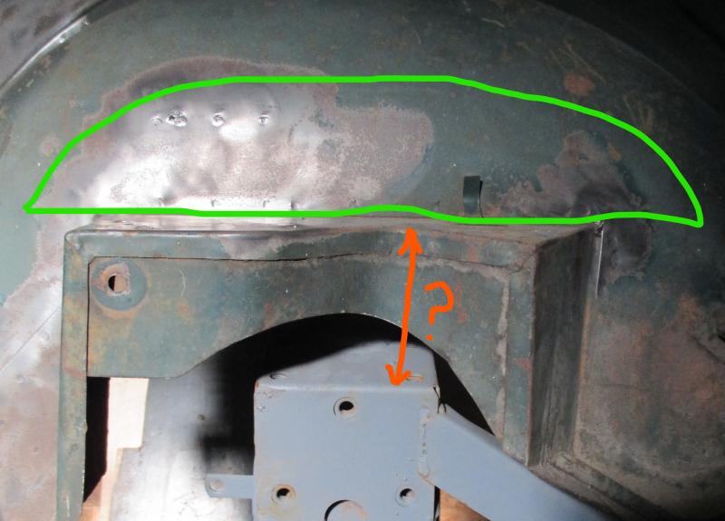

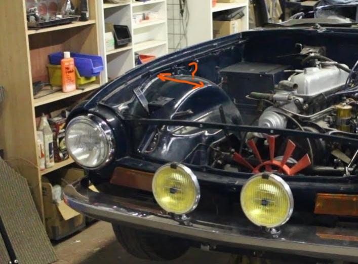

Planning on fitting TR 6 cyl into my next project TR4A, and require some measurements to modify the right inner wing/fender shelf/indentation to TR6 dimensions.
Is the bottom of the indent of TR6 at the same level of the 4A shelf ?
Distance from outside to the top of the shelf ?

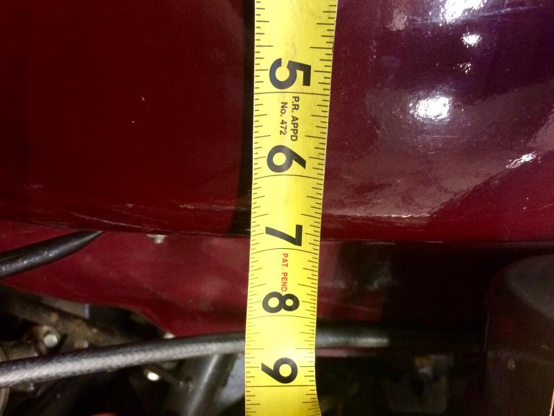

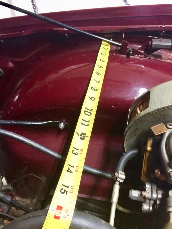

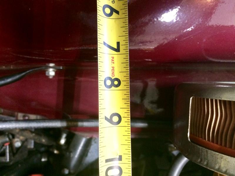

Based on your first pic here is the dimension from the Right inner wing to the start of the shelf.
The measurement is 7" (178mm)
See my pics below. Hope this helps.

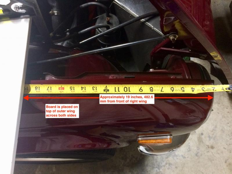

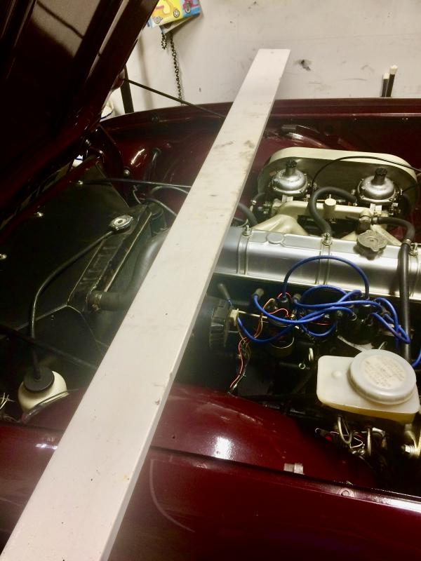

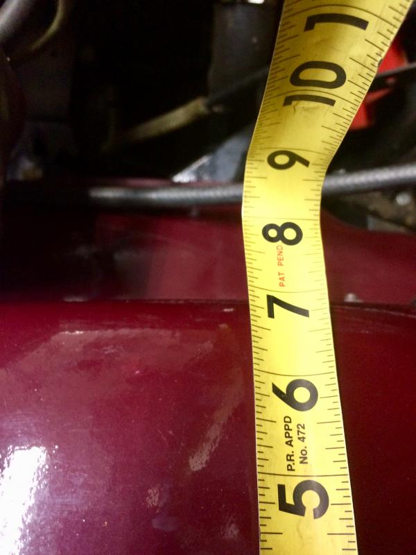

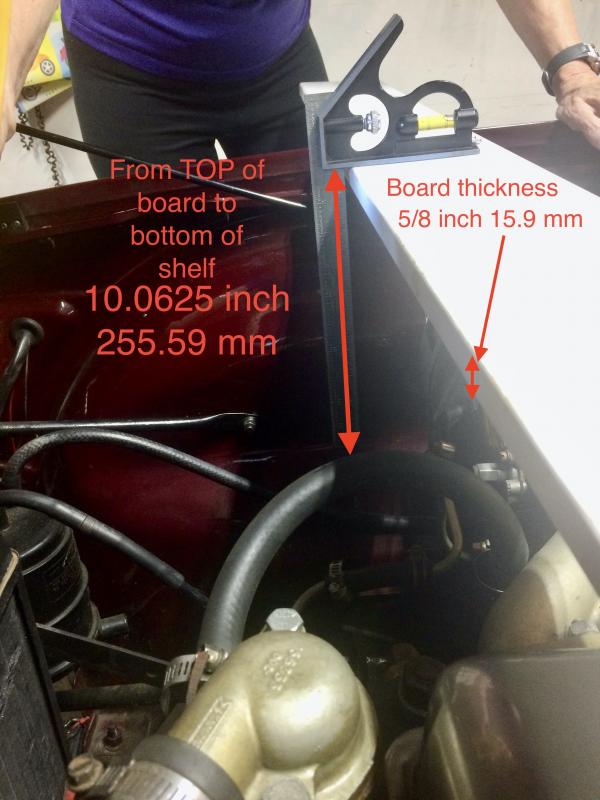

I placed a board across the top of both outer wings (see pic). Board thickness is 5/8 inch (15.9 mm).
Height from TOP of board to bottom of shelf is 10.0625 inches (255.59 mm)

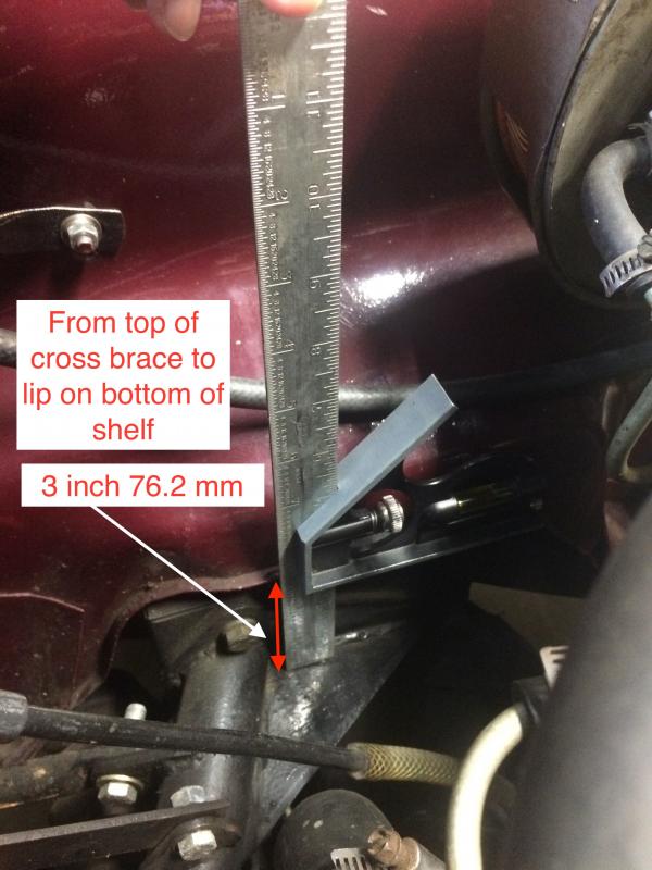

Height from TOP of cross brace to bottom lip of shelf is 3 inches (76.2 mm)

I placed the board right across the front fenders (wings) approximately 19 inches from the front of the front of the fender (directly above the headlight).
