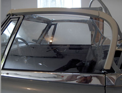

robert_ellison
Re: Replacing BJ-7 convertible top.
Thanks Dave!

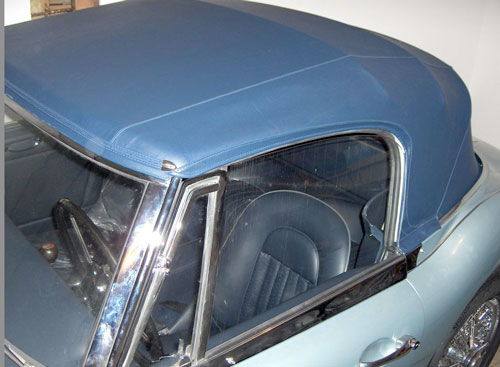

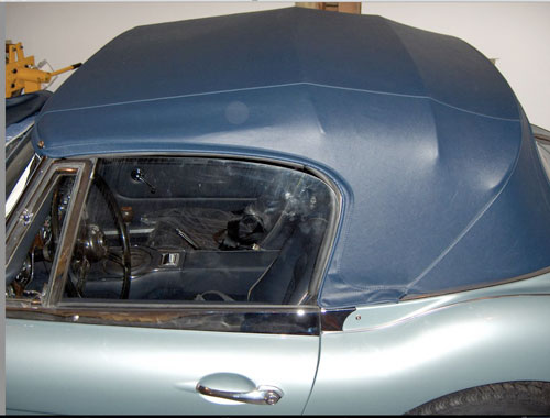

Could you also provide images of the rear window and attaching to rear and front bar as well as any tips/installation instructions you can provide that might be useful.
I posted your photos here
I greatly appreciate the assistance in filling in the blanks so those who want to do it themselves, or can't afford to have the job done professionally, will be aided in doing a proper job.
Robert

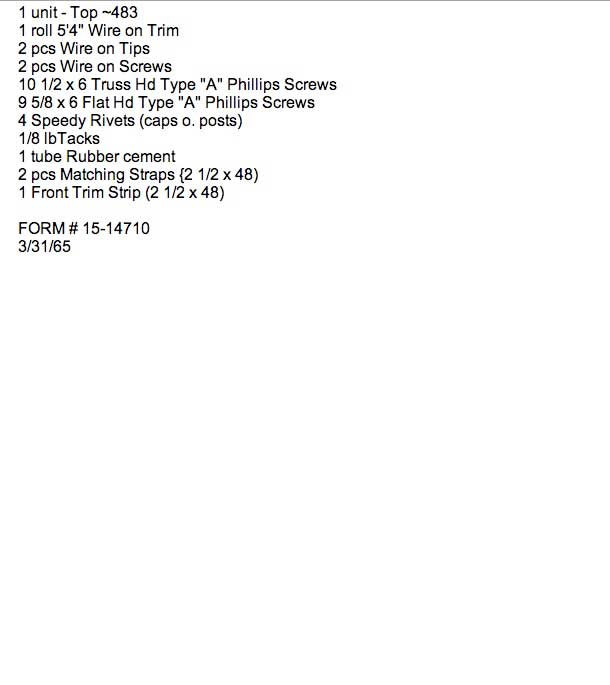

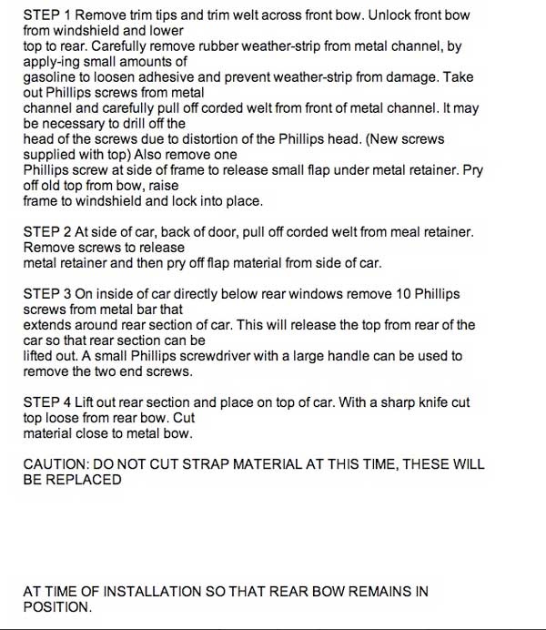

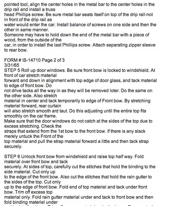

robert_ellison

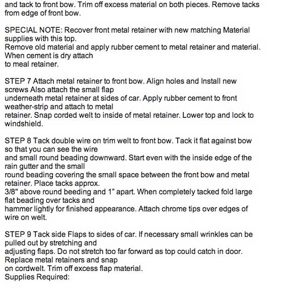

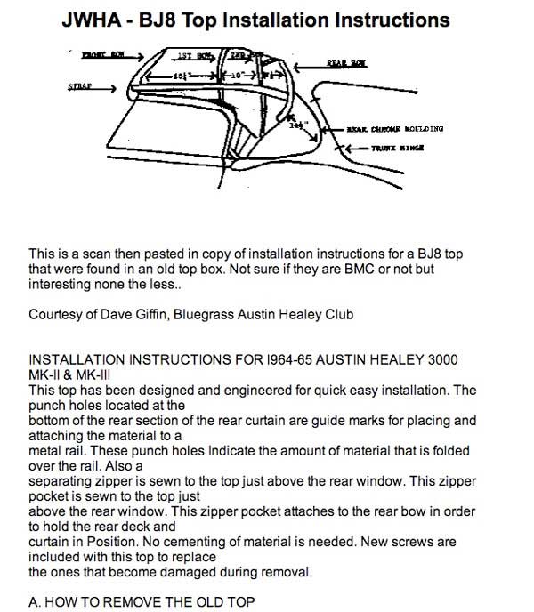

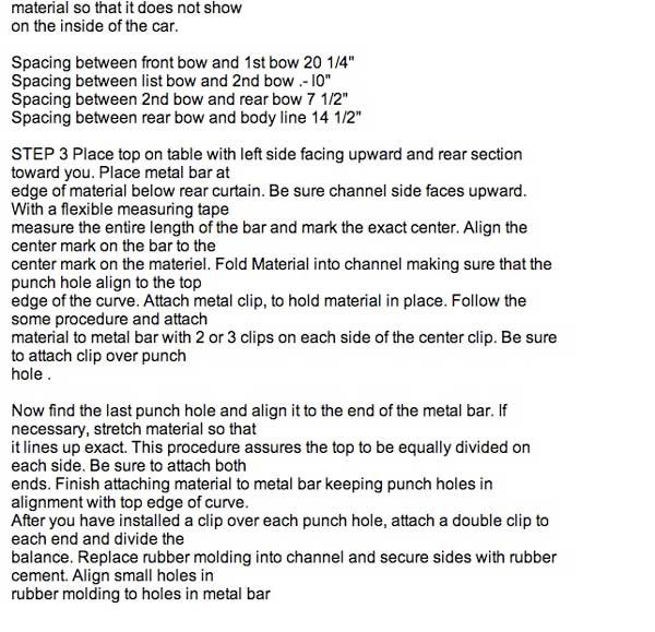

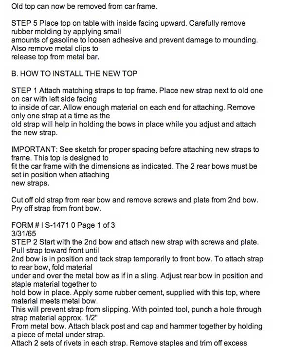

I also found these instructions which still leave a lot which I don't quite understand but they might be helpful to someone:
