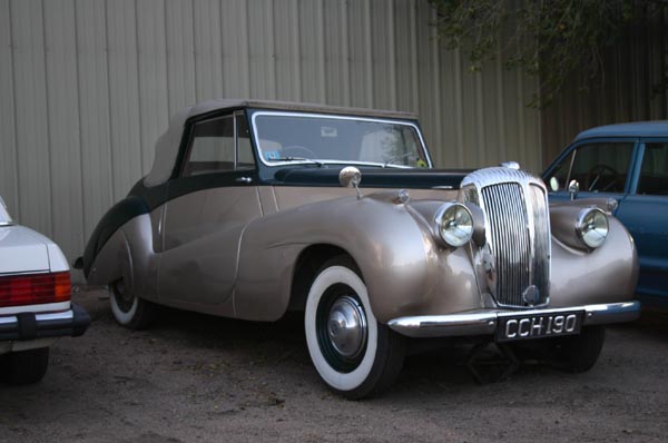

FOr example, the image I have attached to this reply of my 1950 Daimler started out as a huge image (2048 x 1360) at 180 DPI with a file size of 1.2 Meg! All I did was resave it under a different name but resized it to a width of 600 pixels and medium quality JPG and the file size is a mear 50k! Yet the image quality is more than adequate for viewing on a browser.
