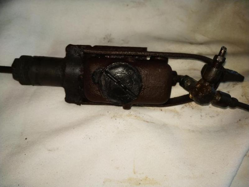

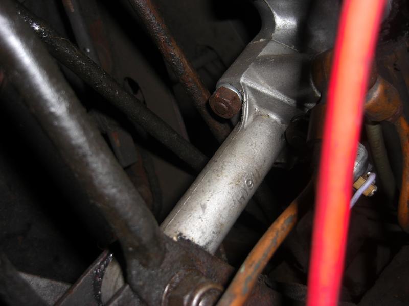

Well, I started digging into the car today. It is a bit of a mess. I hope that i didn't get in over my head! It turns out the the master cylinder is a Frankenstein monster and is definitely not original:
It looks to me as if someone cut the front of the original off and welded an American master cylinder to the back end. What a mess. I hope the I can get an original replacement.

trrdster2000, I have no idea how the master cylinder is suppose to mount to the firewall of the car. Would it be possible for you to take some pictures of that for me?

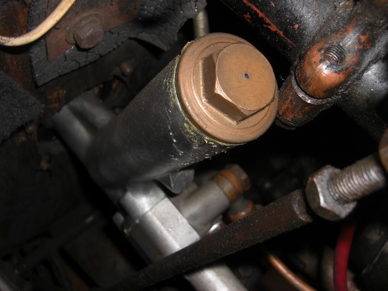

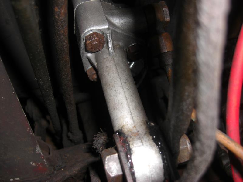

Hal, will get you a couple tomorrow.
The rod with the pedal on top is the rod that goes into the master cylinder to displace the fluid to the pipes. It's a tall fill chamber and has a inline pressure fitting to operate the brake light.
I told you it was odd.

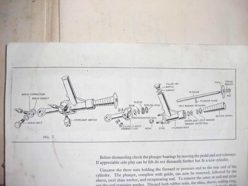

Hal, Here is a couple with a picture of the rebuild kit instructions.CIMG0574.jpgCIMG0576.jpgCIMG0575.jpgCIMG0577.jpg

Thanks trrdster2000! The pictures are exactly what I needed. The brackets for mounting it to the car seems to be original. Let me see if I can find an original M/C. I have a complete set of BS wrenches and sockets, so thanks for letting me know.

My apologies guys, I imagined the M/C as being under the floor on this model, not on the lower firewall as pictured, it is quite unique in design, and not easily improved on.
