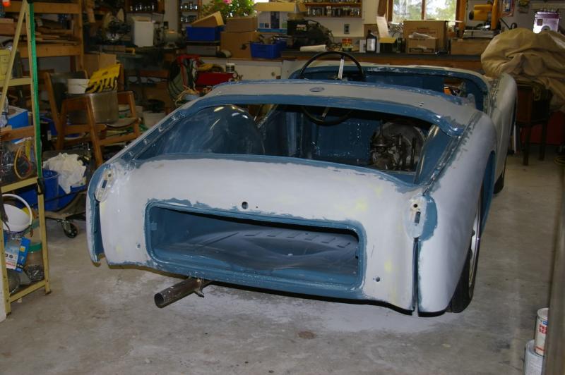

Mickey Richaud
Hey, Lionel -
Don't have the '57 (TS16162L) any more, but I just looked at the photo album of the restoration which I kept after selling, and both sides have a rectangular (or oval? - hard to tell from the pictures I have) hole with a smaller round one above and slightly inboard it. Is that what you're asking?
Mickey
mgedit

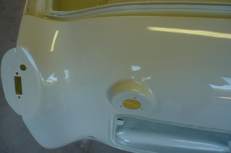

Took a while to track down a picture. Seem to have taken few pictures from directly behind during the restoration. Mine is early 56 (TS11537), and here are the holes on mine ... both round and rectangular. No idea when switch took place. Maybe when middle light changed to one with chrome on it? Cheers, Mike

Thanks for the rapid response guys. That is exactly what I was referring to. Your phot Mike shows a clear image of what my rusted panel has. I guess they just carried the old metalwork forward even though it was no longer required. I am in the process of forming a new panel and was wondering whether I should include the rectangular cutouts.

Lionel and Others,
My 1957 TR3 has the round and rectangular cut-outs. The rectangular cut-out has "spire clips" top and bottom, where the screws for the chrome light plate are threaded into. The round hole is where the wires pass through. I also notice that that whole oblong area has a slight recess, which allows the wires to sit behind the chrome fixture (which itself sits on a rubber gasket). The wires pass through the one hole in the body, then separate to pass through the gasket and plate in two holes, one to the left of the bulb and one to the right of it.

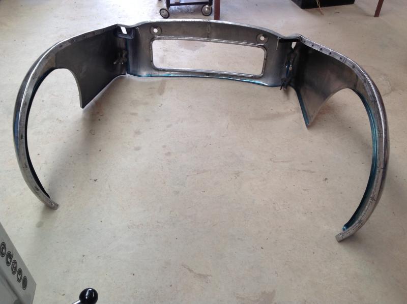

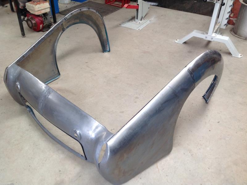

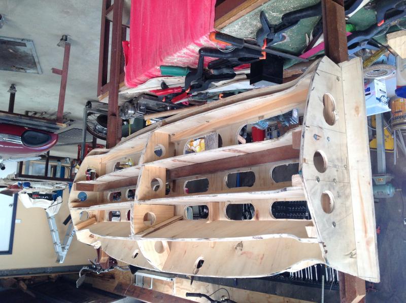

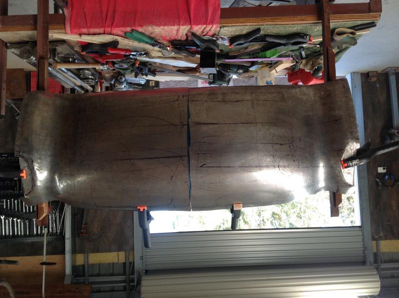

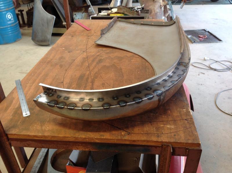

LionelJrudd
Hi David.
attached is a photo of the buck I made taking profiles from the back of the car and then the two roughed out halves before welding together. Still got to detail the line around the tail light locations. Sorry but looks like the photos are upside down, regardless of which way I have them on my iPad. Will upload some more shots when I have finished the metalwork and sorted out how to get them rightway up.
regards,
Lionel
DavidApp
That is hard core restoration. You must have a background in sheet metal.
Looking impressive.
The photos are the right way up for you.
David
L

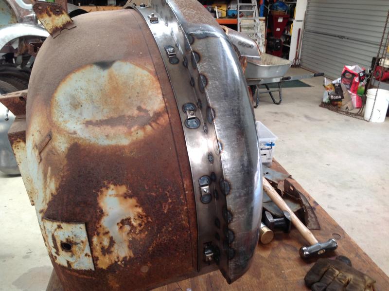

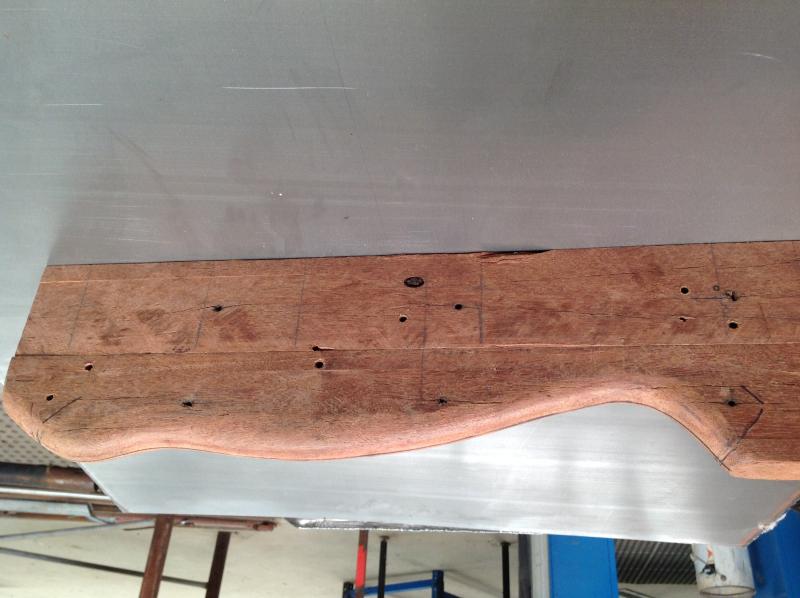

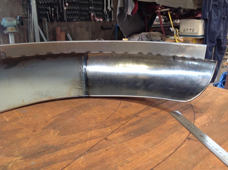

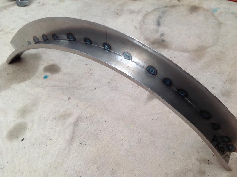

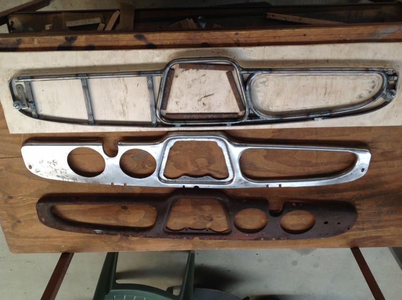

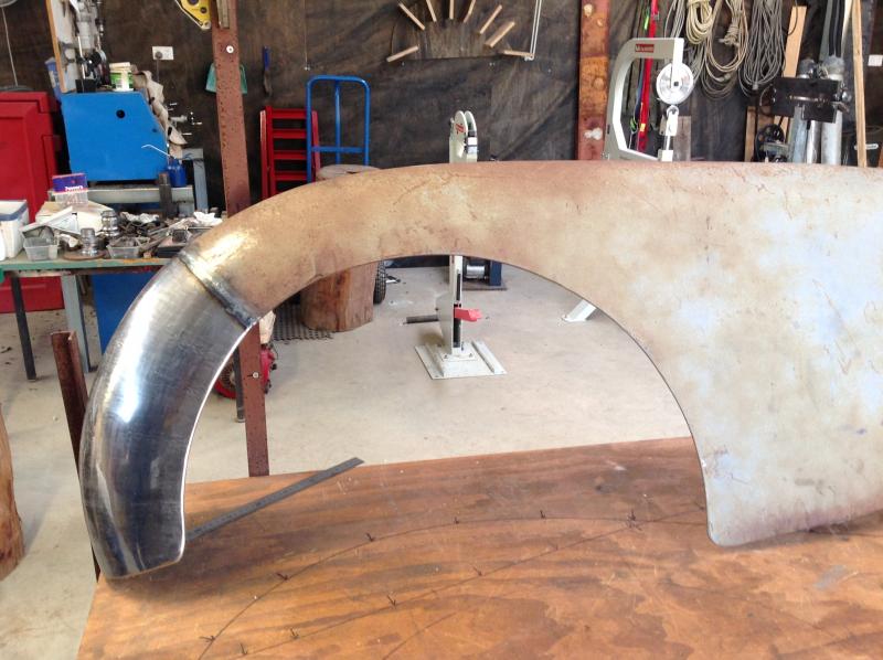

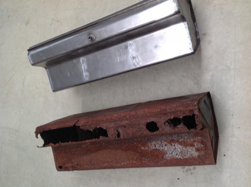

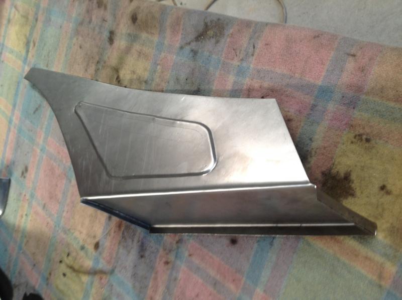

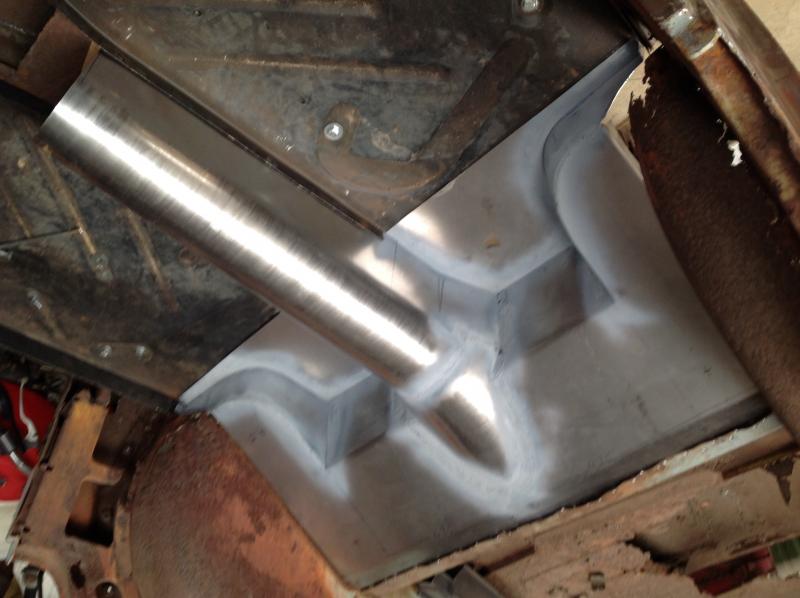

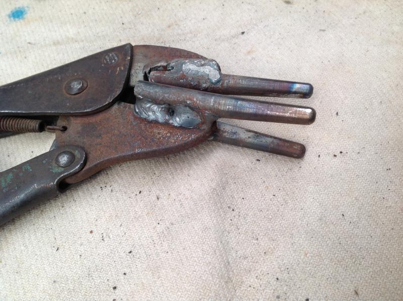

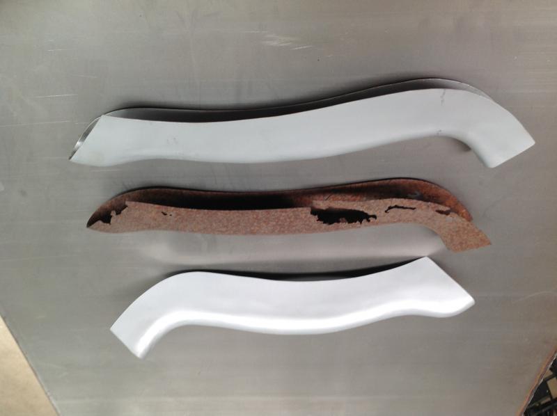

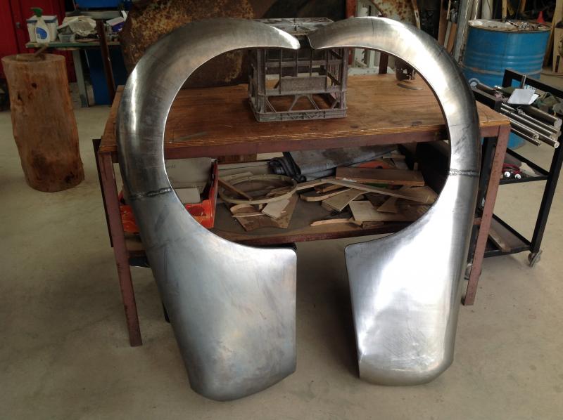

LionelJrudd
Hi John, David, Just self taught with a lot of you tube viewing. My background is in teaching and IT.
I have a cheap English wheel which I used to raise the middle of the panel and to smooth off hammer marks. Also got a basic shrinker / stretcher. The type of gear you get from your Harbour Freight company in the US. Built myself a bead roller per the type you get in HF with a few improvements compared to their model.

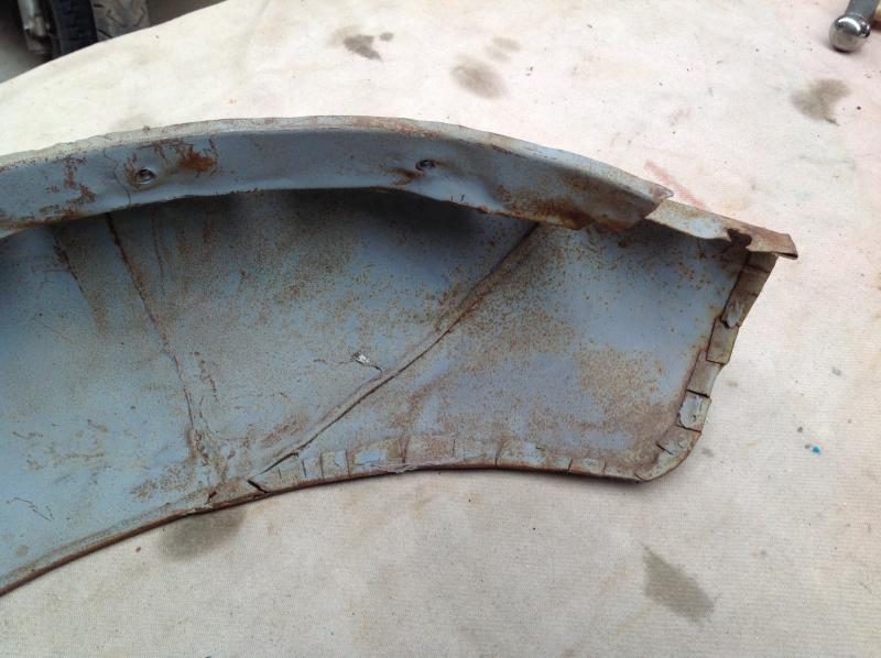

I found the panel was too big for me to handle well in the wheel by myself so cut it in two after I had the basic curvature sorted. The major shaping was done with hammers and sandbag. As you can see from the photo below it never looks good to start with. In fact I got depressed with it and went off and rebuilt a motorcycle for some time before I came back to the panel. Woke up one morning and decided it wouldn't change shape by itself so started hammering on the sandbag again.
Lionel

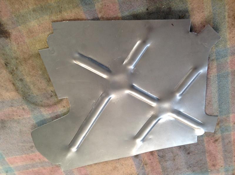

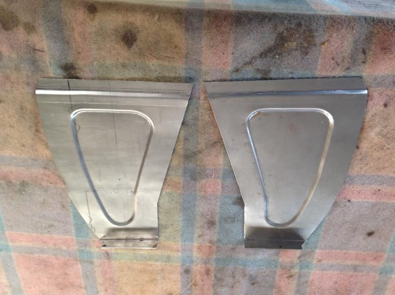

Some other peices I have had to make.
My car is left hand drive and I want to covert it to RHD so I made a former whichcould be flipped over to fabricate either LHD or RHD dash panels.
Only one rusted arm rest so I made a straight wooden former and and made left and right halves which allowed me to then produce the left and right hand curve for each side of the car. I then fitted the halves together and tigged them along the longitudinal axis.

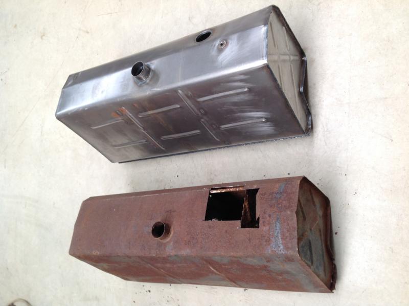

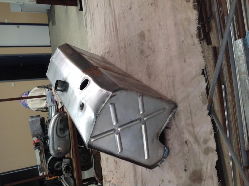

Fuel tank was wreked so made a new one. Turned profiles for the bead roller to impress the panels.
