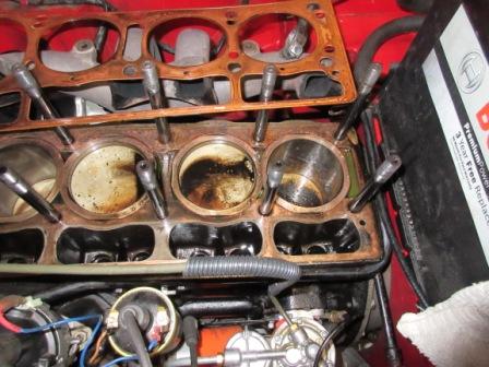

I've torn it down. Head will be off in the morning. I eliminated all other possibilities already. The head was done by the best guy around. A pro beyond question. New guides and valves. Seats are all fine. Leak down test passed. But the piston chambers are wet with oil and the edges are washed out because oil is being sucked up past the scraper ring. My compression rings were identical, had no bevel, and no up or down. County piston, sleeve and ring set. I'll check those rings, though, and be sure they weren't defective. As for the scraper, I too am concerned they hopped when I put that compressor on. I'll get to the bottom of this. The best minds around town are all telling me it's the scraper ring arrangement--or defective scraper rings.

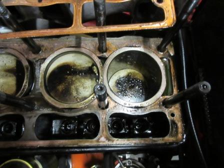

Geo--You know what kind of hours I keep. I would've had that head off last night at around 1:30, but I couldn't muscle it off. It kept catching on the studs. I'll have it off here shortly.

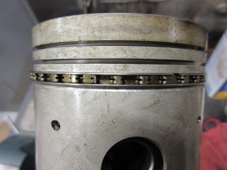

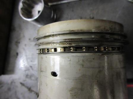

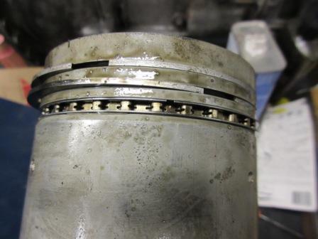

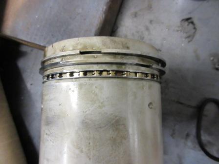

I've learned a lot, and the photos tell it all. Here's the verdict: Those scraper rings hopped into an overlap and I missed it on all four pistons. That explains why such a mundane "of course" issue is treated with special instructions. I just didn't realize that when you put the upper and lower holding rail/rings on you "must" be so darn careful to avoid allowing the scraper to hop and overlap the adjacent ridge.
I'm very willing to admit my foibles, but to help others avoid this in the future, let me just point out that I tried two test runs on each removed piston and, without fail, those scraper rings hopped over again. The only way I could get it correct was to hold the scraper ring down with my thumb as I installed the upper and lower holder rail/rings. Seriously--every time.
Then, to make matters worse, take a look at those compression rings. I swear I had those gaps close to 90 degrees apart. That means that my ring compressor moved them. All four of my pistons show the two compression rings moved. I'm going to look into a better compressor. Or, maybe I should've oiled up the pistons more so that the rings were more stuck in place by the oil/goop. I'll need to figure that one out.
In the photos below, the correct scraper "butt up" is shown in the last picture.
Anyway, that's it. All human error. I did a terrible job on those scrapers. It's all over the internet that you must avoid overlapping those scrapers. I might've had Fox News on in the background when I was doing all this last year.
RingInstallationError1C.JPG RingInstallationError2c.JPG RingSlideonInstallc.JPG RingSlideonInstall2c.JPGScraperRingOverlapError2c.JPGScraperRingButtUpCorrectc.JPG
