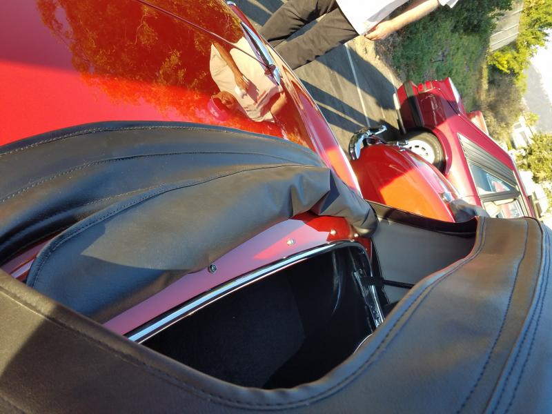

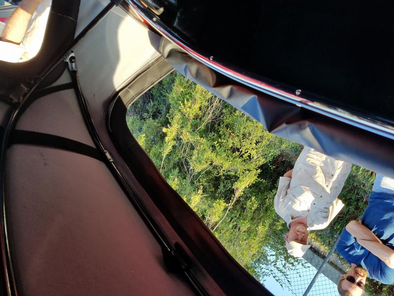

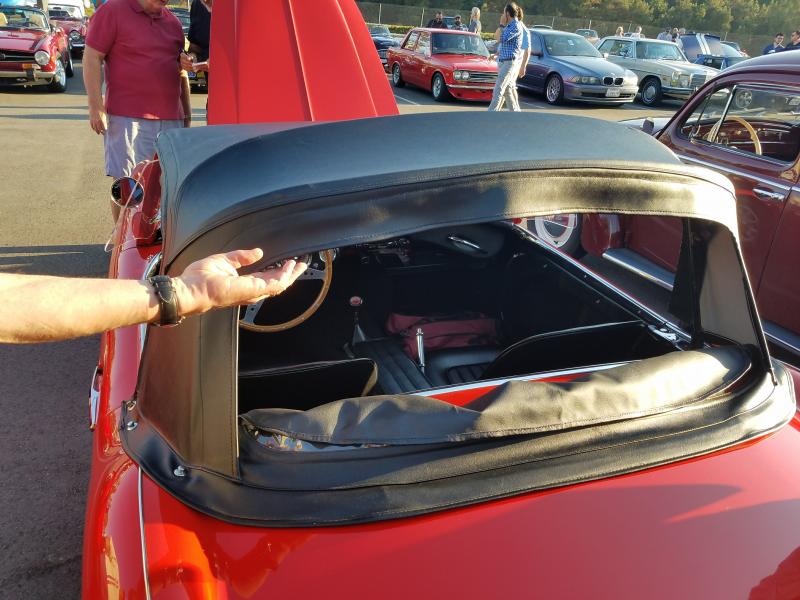

Ken Rocke has built at least a couple of 2-seater tops (maybe 3 - 4) with zip-out rear windows - from scratch. He told me a stock top can't be modified this way. He may have told me why (long forgotten), but I took him at his word. No contact info.
A Souther California club member has one. It may be that this is one of the tops made by Ken Rocke

Guys, I appreciate your responses. The photos are particularly helpful for me because they bring into focus perhaps the one continuing problem with this arrangement, i.e., if the wind remains attached along the bottom seam, it must remain rolled or somehow folded on the rear shroud deck. It cannot be folded downward into the cockpit as is the case on a BJ-7 or BJ-8. As a practical matter this would mean poor aerodynamics as the window portion would flop around in the wind at speed. This would obviously risk compromising the paint surface on the deck, not to mention the structural integrity of the window itself. Somehow I hadn't been able to anticipate this as I stared at my top. The photos were really of great help.
I will consult with an upholstery and top specialist to be sure but I'm a little more skeptical about modifying an existing top than I was when I first posted this note.
Building a new one from scratch may be the better solution.
Thanks again very much.
