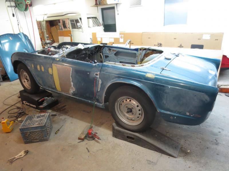

Thanks! The rear ramps are just your standard cheapo plastic ramps you can get at any auto parts store, I think they are a 6" lift. The ones at the front are 2-piece Race Ramps, with a 10" lift and removable ramp section. They are great to work with.
https://www.raceramps.com/2-piece-67-inch-race-ramps.aspx
Those are nice. I just had a situation where I needed to raise the car all around (rear suspension work) but didn't want to buy something I might not need often, so I used an idea that was recently posted here on the Forum. I built ''cribs' from 2x4s to hold the front wheels, rear was held by jackstands:
Made a very secure lift that raised the car 10.5 inches. Cribbing has been around a long time.
Great idea. I think I'll build a set for the rear to match the lift of the front ramps. I'll even use PT lumber and exterior screws to facilitate outdoor storage! Thanks!
Nice cribbing Geo. I don't however, see any oil on the floor, have you bought a new car that isn't British?
It's British and it leaks.
Those cribs are each assembled in two parts with the 2x2s forming keys to keep the halves together. I did it that way so I could lift the car in two stages (front, rear, front, rear).
Great idea! Thanks, Geo and Mink!

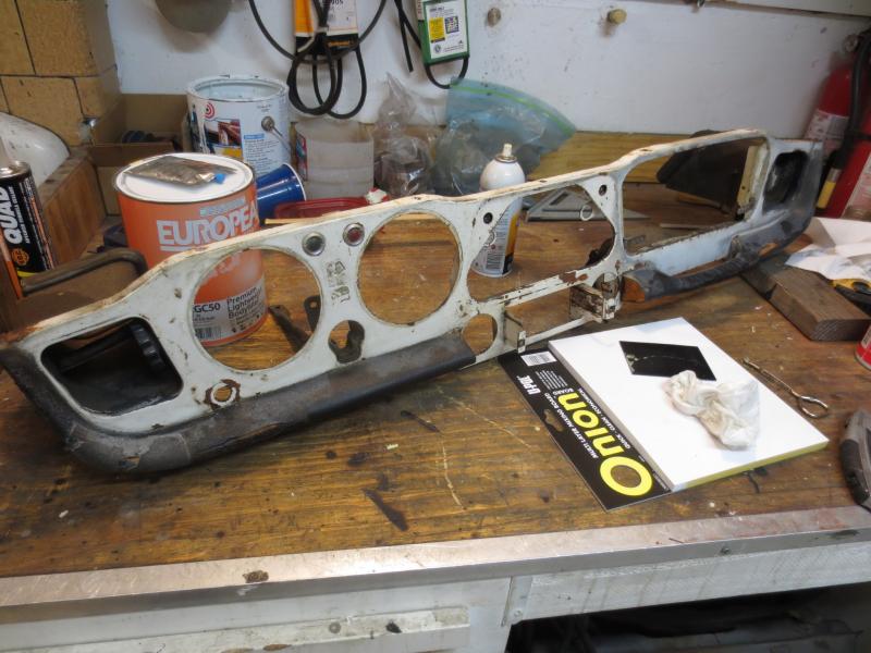

Small update. I reworked the left door, which was ill-fitting, had shimmed hinges and filler in it. Got things back the way they were supposed to be and everything lines up real nice now. Also got the dash out and it's sitting on my bench now. I think the engine and trans will come out next week. I'm not doing a frame-off resto on this one but am going to repaint the engine compartment. Plus I want to replace the main seal and clutch so it just makes sense to pull it.
I loved Geo's cribbing post so much I built my own set for the rear. Thanks again for the idea!
I owe it all to you! ;)
