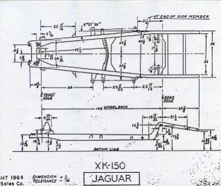

Hi Folks,
thanks for trying to help me ...to be more precise, I am looking for a chassis alignment diagramm. Yes, many workshop manuals show it in the bodywork section. But I do not find it for the XK 140. The one for the XK150 can be find below, but I fear that the XK140 is different from that of the 150.

Thomas
I knew exactly what you were looking for
Bentley didn't make a book for the 140?
