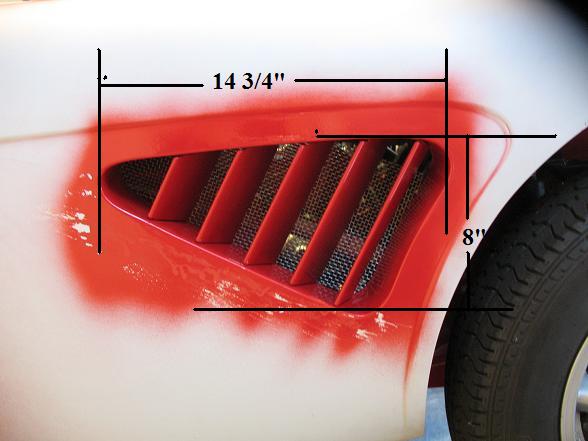

Tim, the measurements for mine, taken from the farthest left to right is 14 3/4" and top to bottom is 8". Picture taken yesterday after initial fit up of fender....plenty of block sanding to do before final paint.
I really don't have an opinion on the final welding approach as I think either could work fine...mine has the step flange on the back and welded on front edge.
Steve

I really like the way you beveled the upper corner of the footbox to allow for more airflow out of the vent. The only problem with me doing that is that I have just installed the one of the coilpacks for my distributorless ignition system on the front face of the footbox.
I just went and looked and I can move the coilpack inboard, to be under the round hole in the brace. Looks like I need to get to work changine my coilpack mounting brackets.

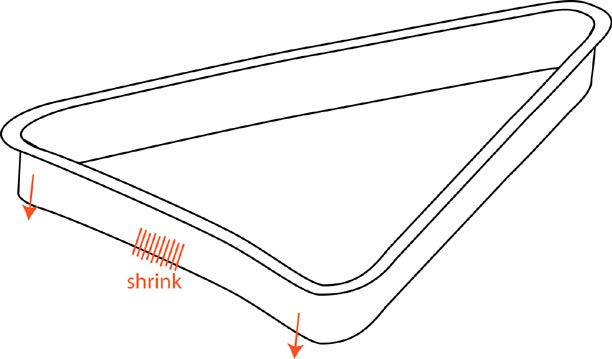

Yes, the folding of the metal will stretch it, what I was referring to was the actual hammer strikes. A rawhide hammer head flexes to spread the load of the hit. Maybe less dents would be a more accurate description. The flange sounds like it will be the finished edge, so the smoother the better.
Cottontop said:
I have a stretcher/shrinker, but the flange is not the area to match. Especially on the vertical front edge of the triangle, the center of the front edge needs to be "taller" than the upper & lower corners to follow the vertical contour of the fender surface.
If the vertical contour of the fender is not followed, the flat flanged triangle will try to force the contoured fender to be flat. THAT is what Steve was warning about...
I was following the logic there, where I was thinking of shrinking was the front middle of the inside of the vent. Here is a diagram of what I'm talking about below. I'm not saying my suggestion is better, just my thoughts.
It sounds like you have both thought it through and know what you're doing. :bow:

<span style="color: #3333FF">>>>I was thinking of shrinking the front middle of the inside of the vent</span>
Another good point. I like YOUR idea better than MINE ! Looks much easier too.
