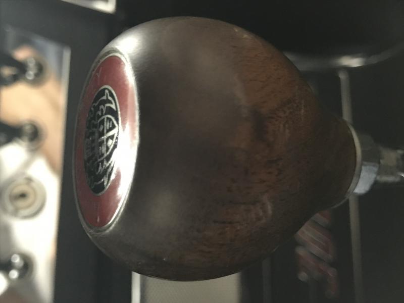

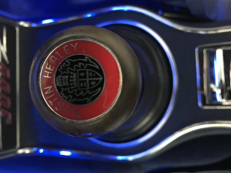

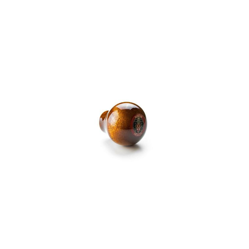

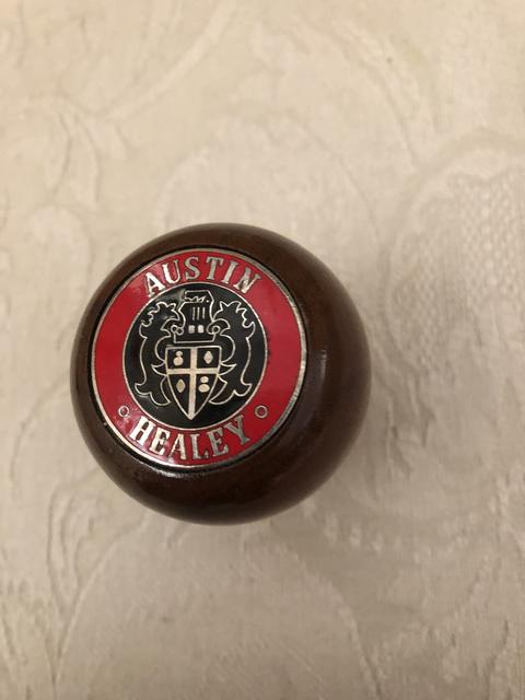

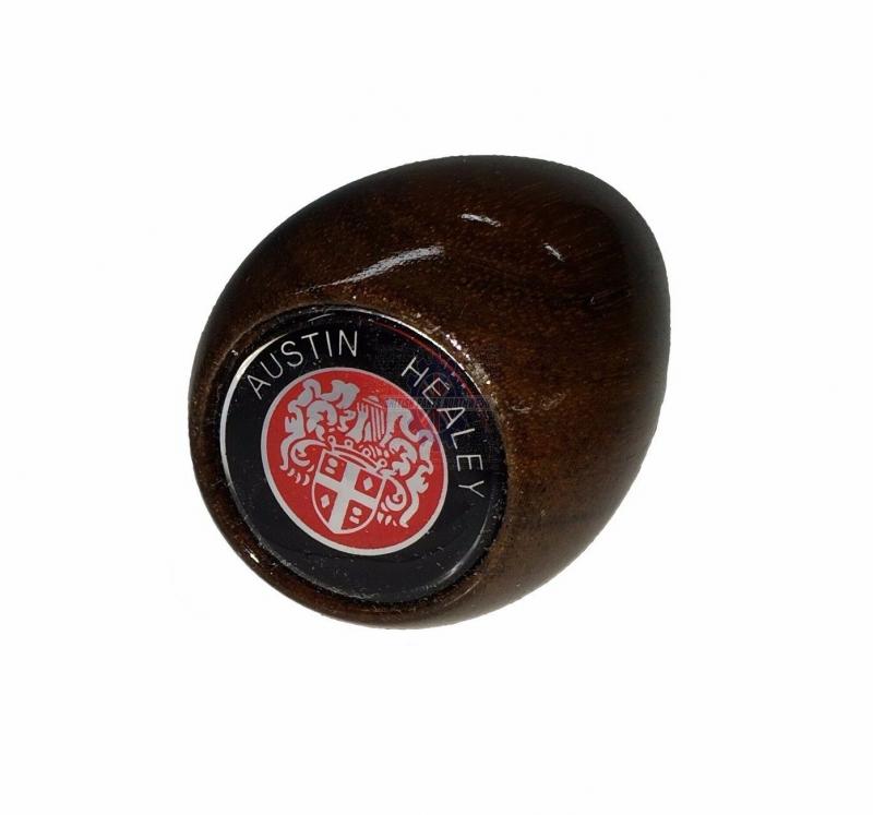

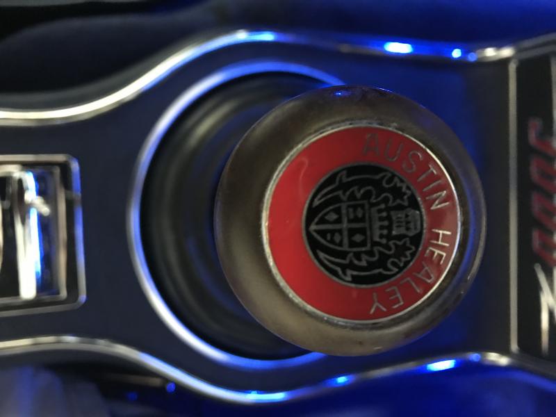

I have what I believe to be a AMCO wooden shift knob, with the Austin Healey cloisonné emblem inserted on top.
From use, the clear coat has worn off the top section.
I would like to refinish it, but not sure what the procedure would be.
What would the steps be and what products would I use?
Here are two pictures of mine, which I call the light bulb style.
After a little searching on the web, I noticed some differences in the style of Healey cloisonné emblems on wooden shift knobs.
I wonder what was the most common one back in the 60's.

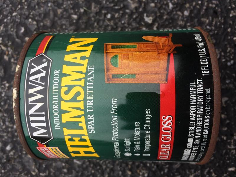

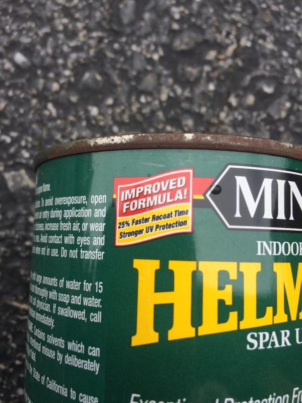

Yes, I definitely used the Marine grade since I was also concerned with the UV. Sorry, I took a pic of the wrong can.
Success.... I found the can on a shelf in my garage.

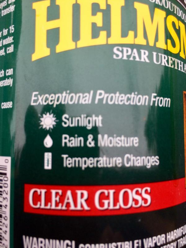

Interesting. I'm leaning toward that same product, Spar Urethane.
You first mentioned your product is a polyurethane, yet the label says Spar Urethane.
It's confusing what these product actually are.
Is it a Urethane or polyurethane or a varnish?
Most likely a combination.
I was in Home Depot last night, found Rust-Oleum brand, Varathane Spar Urethane. Description on the back of the can: "Varathane Spar Varnish provides maximum protection for all your outdoor wood projects."

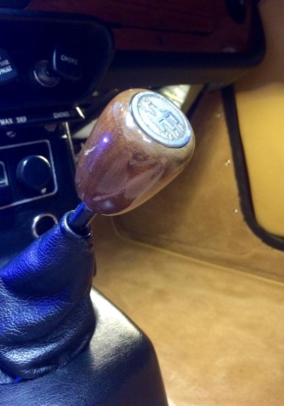

It has been many years since I refinished mine. Honestly I don't remember how many coats of urethane I applied but I would think 3-4 coats would be sufficient. Let it dry for a day or so before using the steel wool.... don't rush it.
Here's a pic of mine. It's been years obviously there is some wear. Sorry about the reflections in the photo.
Nice :)

My father had the same car and I remember as a kid, he had a walnut shift knob that looked like a light bulb with the Healey cloisonné emblem. More likely then not, it was this AMCO knob that I have. In my first post, I showed examples of the different types of knobs and the different Healey cloisonné's emblems.

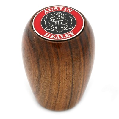

Style sold now by the usual suspects is this one.

I'd be interested in a NOS of the exact AMCO walnut knob I have now, which currently, my search comes up as not available anywhere. As I mentioned, I don't want a different shaped knob or different Healey inlay. Search will turn up, different shaped knobs, different Healey inlays, knobs made of different types of wood, aluminum, colored carbon fiber, vinyl and prices ranging from $25 to $95.
Being a replacement isn't currently available, I decided I'll refinish mine. My post was simply asking for guidance on the how to procedure. I'm restoring mine for $12, the cost of a spray can of Spar Urethane and some sandpaper. And being a meticulous guy, when I'm finished, it'll probably have a better finish then what this NOS AMCO knob had, when I bought it 13 years ago on Ebay.
