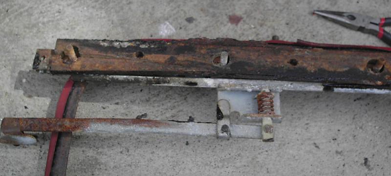

Which way around do the wooden seat runner packing strips go? Big holes to the front or small?
Yes big holes to the front. A tip that I did may help you, I made longer metal straps to go on top of the wood strips. The longer length helps hold down the front portion on carpet and prevents it getting chewed up by the seat track as it slides over top of the carpet edge. I also made them out of aluminum so they wont rust.

I added metal strips under the floor and added large fender type washers under the heads of the nuts, thinking it made the possible tear out of those seat retainers bolt less likely,in the event of an accident.
Thanks guys. Went to fit the seat pans yesterday and realised I had only bought two seat runners instead of four, doh...
