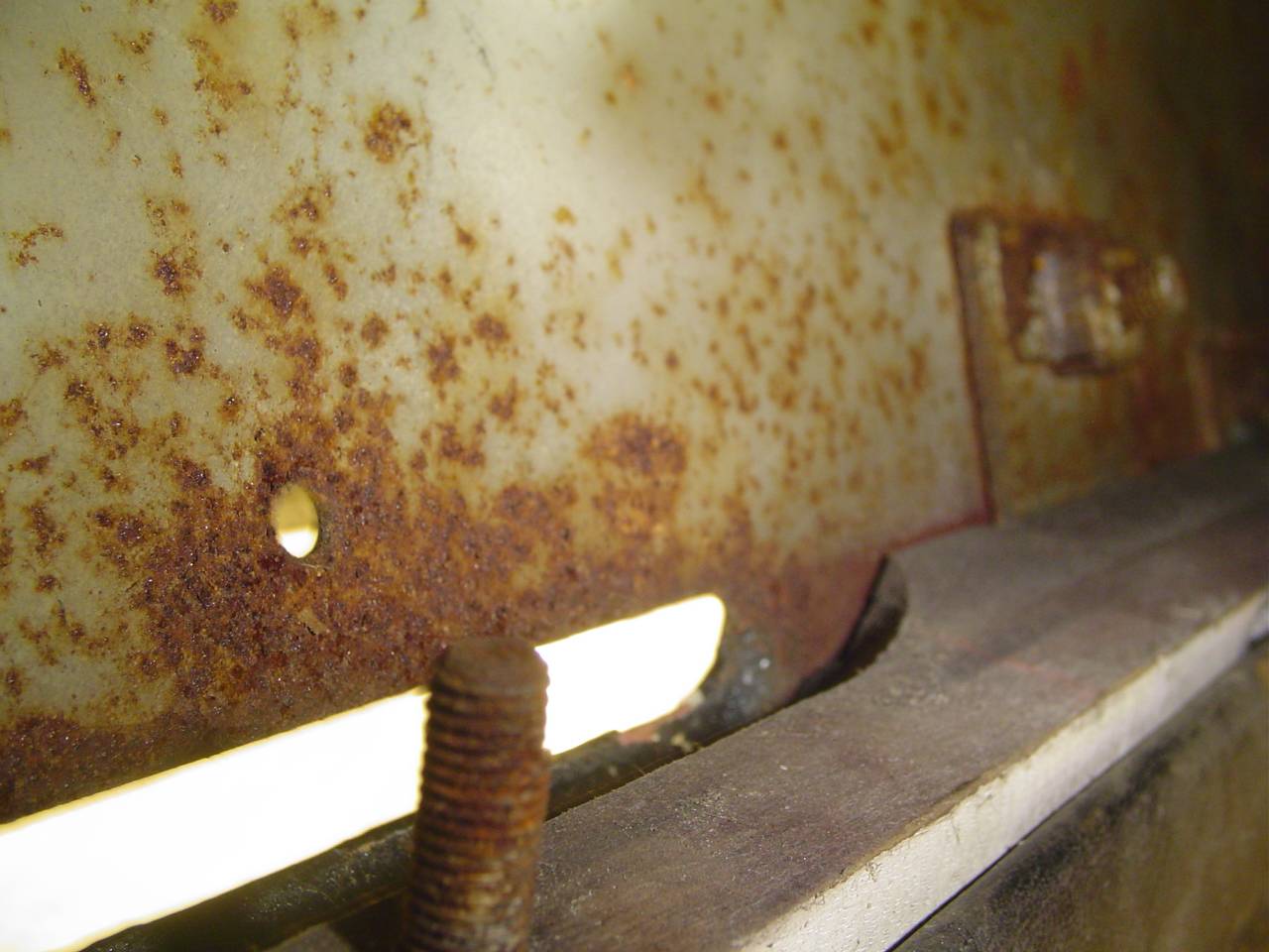

We searched for a source of these pieces with no luck. My car must have been mistreated in its early history because most of the wood (we believe this is ash or yew) was in very poor condition. We carefully removed the wood from under the scuttle and traced out new material using glued-up laminations of marine plywood. All of the edges of the plywood were sealed with marine varnish before the wood was replaced. Note: we noticed that without reinforcement in this area of the car the sheet metal had a tendency to 'drum". What I mean is that there were definite waves (peaks and valleys) in the surface. These leveled out when the wood was replaced. Unfortunately I don't have many good photos of this aspect of the restoration.
As an alternative to wood, you might consider a stiffener made of mild steel. This can be attached to the underside of the scuttle with industrial grade adhesive. You can attach this temporarily and mark the stiffener for the necessary holes. Then you can use speed nuts for all the attachments.
Good luck

I think that I can use the old peice as a pattern and try out my carpentry skills, Paul (apbos) has the same condition. so we will be working together with the information.
