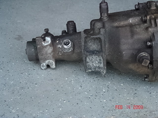

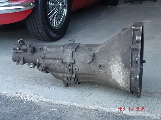

I purchased a Datsun 210 box from a fellow enthusiast for my Bugeye. The good news is I got it for short money. The bad news is the rear mount is damaged. Apparantly, it came from an upstate NY car that was exposed to cold, wet and salt. The rear steel rear transmission mount had been left on the transmission and over time the galvanic action between the steel mount and aluminum trans caused the rear mount to break. Looking at it, it appears there is enough solid aluminum square enough to TIG a piece of aluminum bar stock into place. Or I did talk to the Rivergate guys and they said they might have an extra rear case.

Here is the damaged area.
