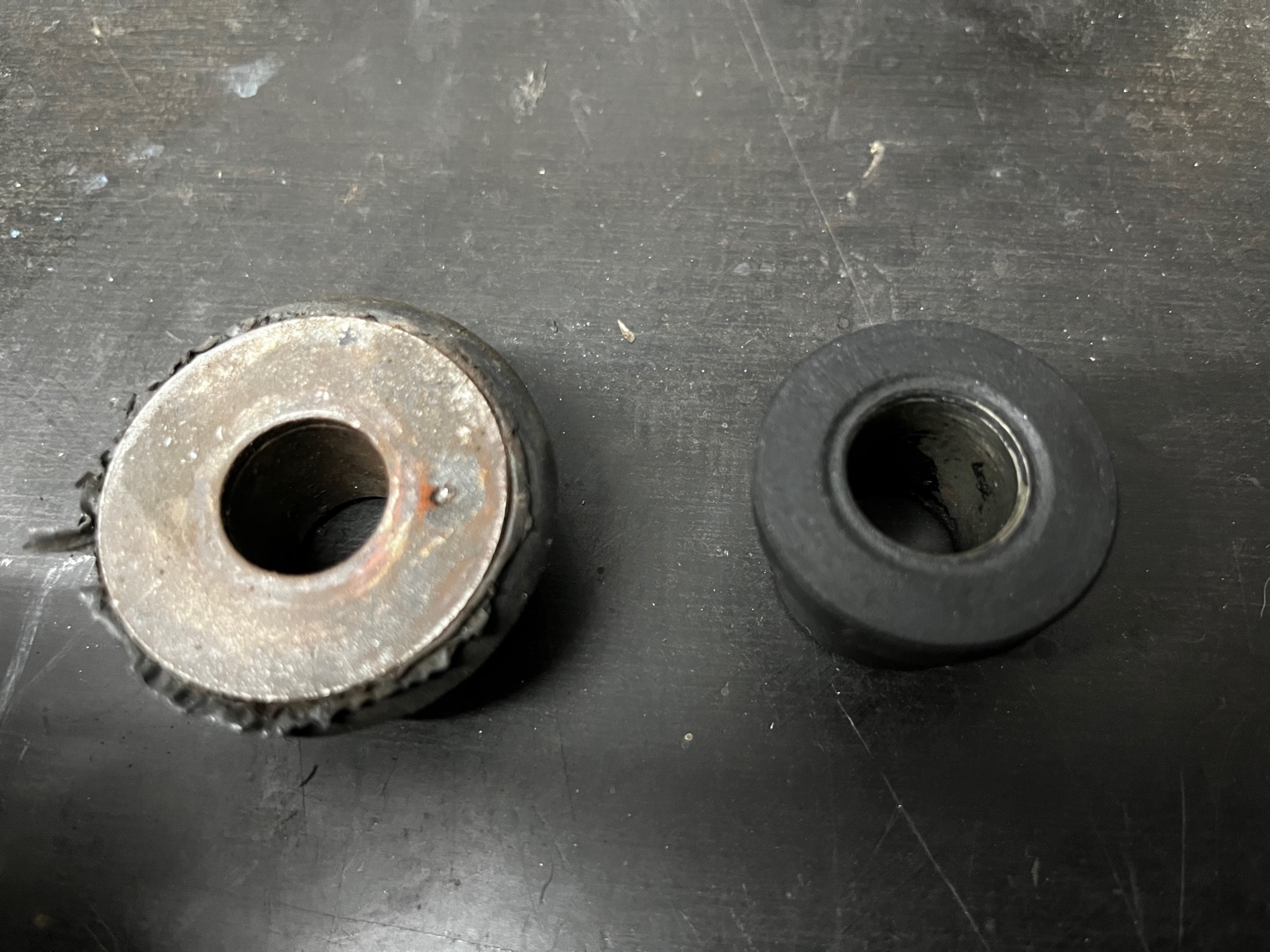

The old bushes (not clear if they are original) have a large metal washer bonded to the outer end which bears against the bracket on the frame whereas the new bushes do not have the washer. (see accompanying photo)
Has anybody seen the older style bushes previously? It seems that they are a far better solution than the new ones and would reduce the friction between the bush and the brackets on the frame (if kept lubricated anyway) and possibly provide a more rigid connection between the wishbone and frame. I am assuming that the new bushes are all that is available these days?

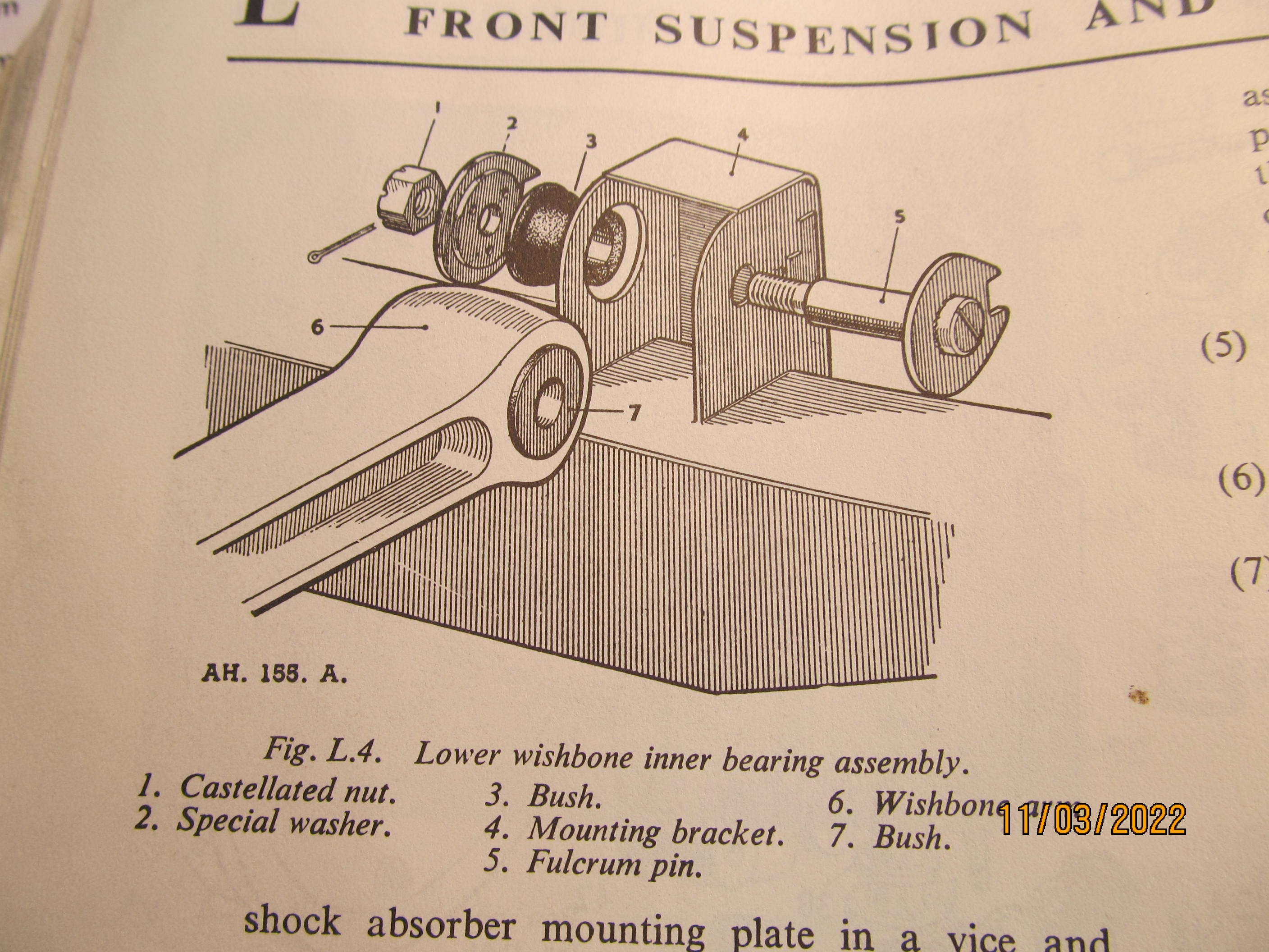

If you are using the rubber stock type bushes, there should be no lubrication (other than plain water to help assembly). They are designed to be locked into position and not are not supposed to slide in the control arm or over the pin. The rubber is intended to simply flex as the arm goes up & down. That is why it's important to follow the direction in the manual when installing them and have the assembly at normal ride height before tightening the nuts on the pins. If you have the suspension in full drop when you tighten the nuts, you will over-stretch the rubber when it goes over a bump and the rubber bushings will fail prematurely. Pictures from Bentley Book, Section L.5. There should be no additional washer like shown in your picture - that may be aftermarket urethane or ???

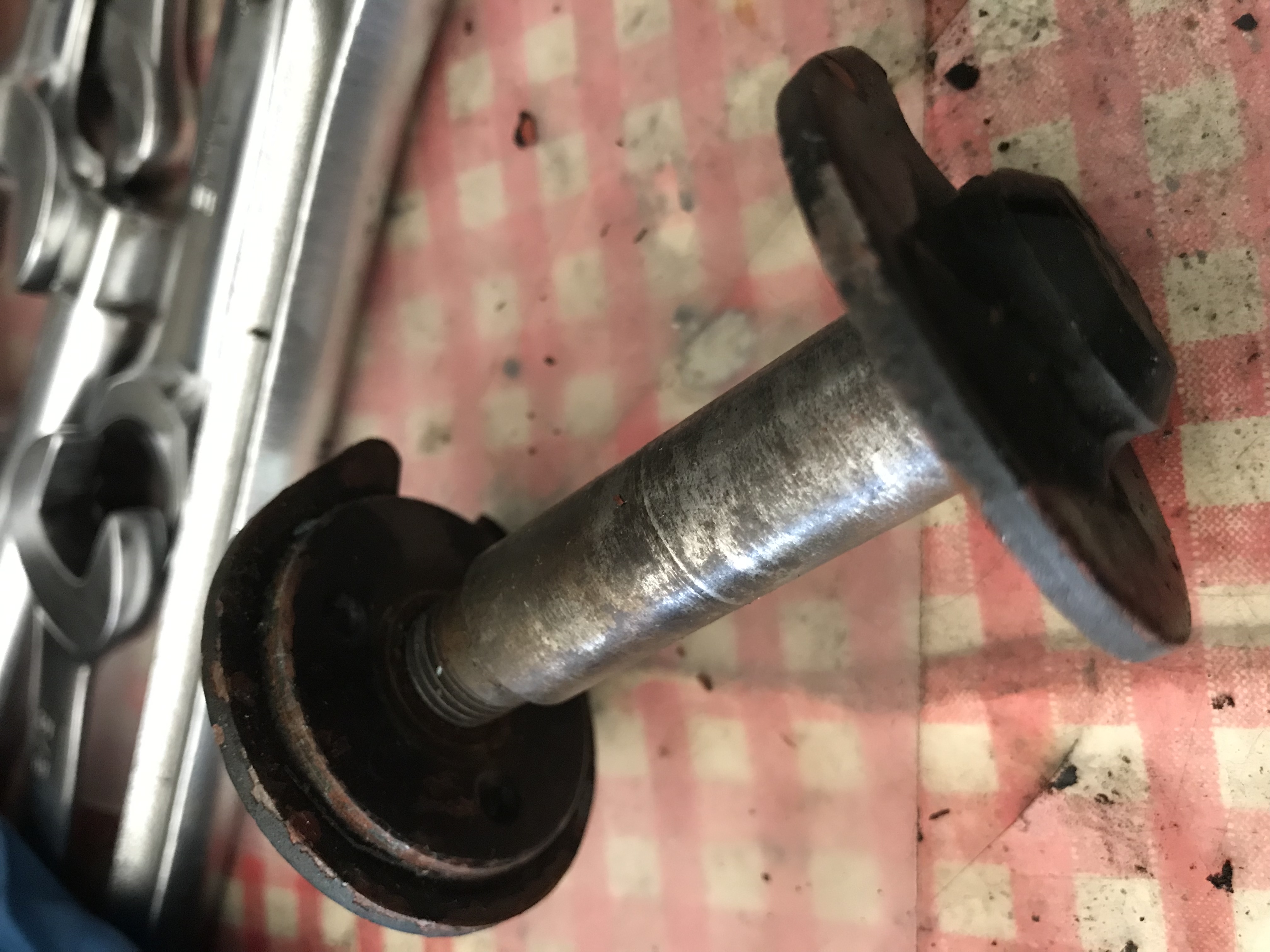

I wondered if the steel washer on the bushing was actually from item 2 (special washer) in IMG_7249.JPG.

Actually, I HAVE seen those bushes with the washer as part of the assembly, so I surmise that it had only been part of the earliest 6-cylinder cars (and possibly the 100s, but I don't have any memories_remaining_of working on one). I suppose the bonded washer bushes were phased out sometime early in the production, but I can't say if it was pre-post around the time assembly moved to Abingdon.

On my BN4, it seems that the Special Washer, #2, is like the Bentley manual.
Also, as Dave said, the rubber bushes get no lubrication, but flex to allow movement. The bushes should have a metal sleeve in the center. This sleeve is held tight by the two washers. You might consider putting some anti-seize on the new pins to make them easier to remove next time.
