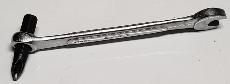

Two solutions:

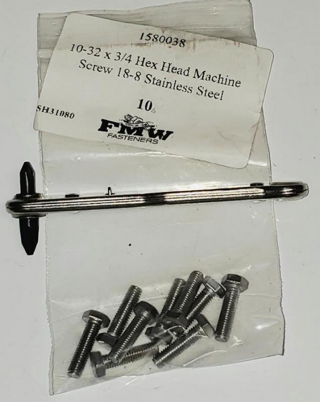

A third solution would be to cut the head off a 10-32 screw, loctite it in place and use as a stud.
I already tried the offset Phillips. Mine is not as good as the one shown - more like half a swastika. It can't get a grip on the screw slot. I do have an offset screwdriver something like the one you show but it's for a slotted head. The bottom machine screw is rusted, not like the top one that came out easily. (Why does this always happen to me?) The Loctite method might work if it will stick to a rusty rounded screw head, but knowing my luck, I'll bet that it will just spin off. I could file off the rust I guess. What's the second method?
Real problem is head is rusty and slot is buggered. Can't get any leverage on the offset screwdriver. Just turns in the slot. I could cut the head off but then what? What idiot put that fusebox opposite the clutch M/C when you had the whole fenderwell available?

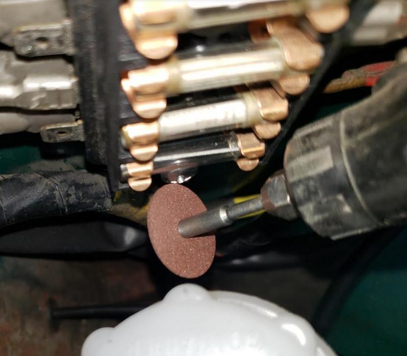

Another method for removing lower screw:
--disconnect battery
--remove top screw
--shoot phone pix of wire placement on fuse box or make sketch
--remove all wires from fusebox
--soak lower screw with Kroil or PBblaster
--rotate fusebox 90 degrees to front, better exposing lower screw
--cut screwdriver slot in lower screw with dremel cutoff wheel
--remove screw with right-angle slotted screwdriver, such as 1/4" wrench with slot bit similar to above phillips.
