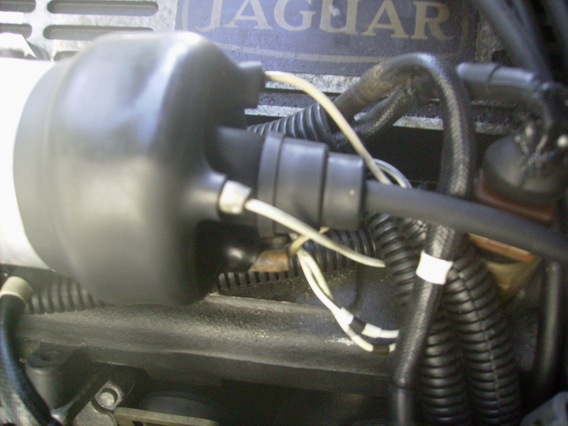

here's a pic of my car's coil wiring - they are all solid white, or white with a black or maroon stripe. Sorry I can't do better, this is not my area of knowledge, unless I can go by a schematic.
Thank you exotexs, the white is the same on my car. The other is possible the white/blue or even green on my car. The links you gave me mentioned a green wire in the Crane sections, so I may have overlooked that one. I appreciate the help, nice engine bay also! It seems that I am seeing blue/white as tachometer, so I may be currently trying to start the car through the tach wire......... I'll get it eventually. I have schematics, but they are for the XJ6L, SII. I am looking over them now to see what colors are Ign. START and Ignition RUN. I think if I can get that information, I'll be fine. Thanks again,
