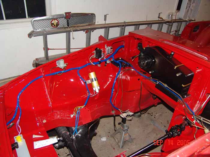

I'm in the middle of my ground up restoration and it just so happens I'm putting in all new harnesses at the moment. My 'behind the dash isn't so bad as I have my car completely pulled apart at this point. In so much as buying a new harness, I would suggest
www.britishwiring.com
My new harness from them looks like a work of art! I'll attach a photo of it when I first layed out the main harness in my bay.
