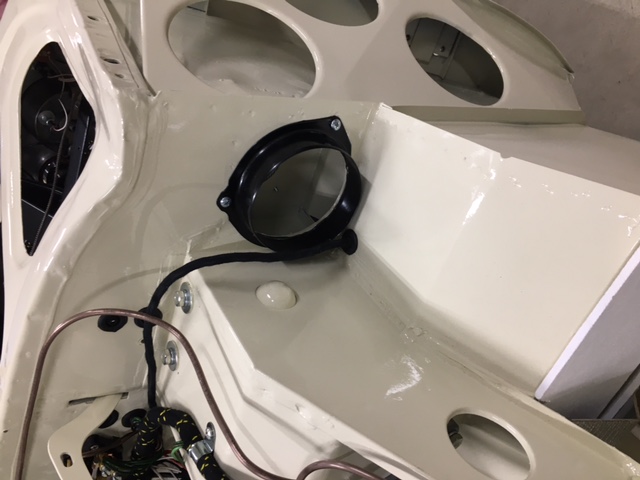

So I’m installing the wiring harness in the 62 project car. This is a Jule superstructure so a lot of the “normal“ holes, etc., are not in the places they should be.
With regard to the wires that go through the top of the footbox down to the low/high-beam foot switch, do they go through the corner next to the fresh air hose collar or over the top of the hose collar then down through the outer edge of the footbox?
Here's a photo.
joe
That’s where I thought they should go . Perfect , Tks Joe

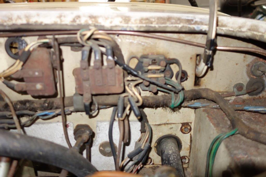

You wouldn’t happen to have a similar pic of the copper oil pressure line that fixes to the side of the footbox and goes through the firewall to the oil/water gauge ?
I haven't re-installed that line yet....but here's a "before" photo. Hope it helps.
