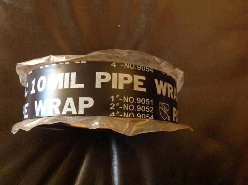

Joe,
I used 10 mil underground pipe wrap on my MGB and it works great...got the idea from a wire wheel shop, but if your wheel bands are in good shape reuse them. Buy good inner tubes, Michelin is what I used and it will last a good long time. Also remove and sticker or labels from inside the tire and use talc to keep it from chaffing.
