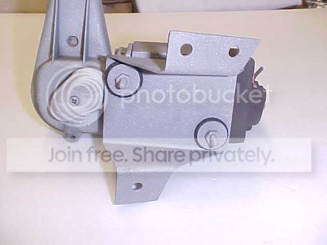

Trying to locate a picture of the bracket for my 56 TR3 wiper motor. It is part 602130 (mount for CRT wiper motor). I don't imagine it would be too hard to fabricate, but I'm not sure what it looks like. Anyone have a picture (or a spare bracket)? Cheers, Mike

Here are some pics, John
https://s960.photobucket.com/albums/ae85/BRITISHROADSTERS/ODDS%20ENDS%20MIDDLES/

Thanks John. Very useful. Assume those are studs that screw into the base of the wiper motor. Looks like there a rubber gasket between the motor and the base as well as the rubber washers on the bottom. Is that correct? Cheers, Mike

I've taken a stab at a layout for making one of these brackets based on the photos supplied by John. John, would it be possible to check that my measurements are right and make corrections as required? Appreciate any input you can provide. Once I've got this sorted out I'll post a final diagram with correct measurements for making the bracket.
Thanks, Mike

That would be OK too, but it would be pretty easy to make with the correct dimensions :smile:
