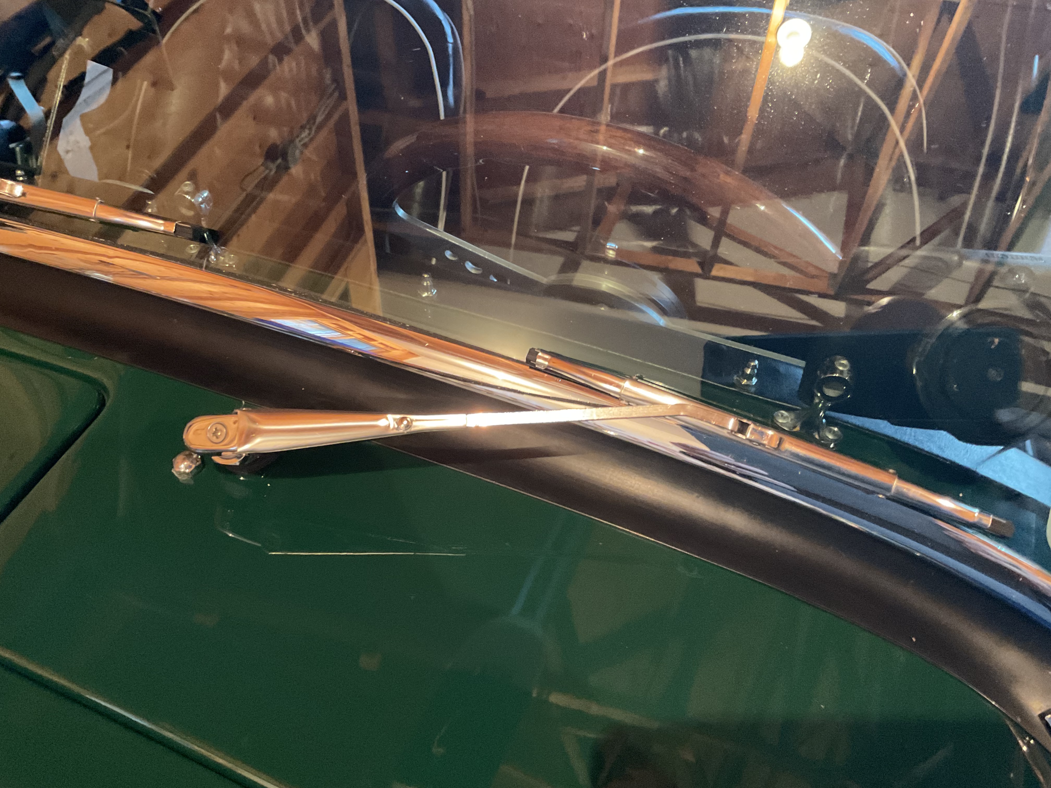

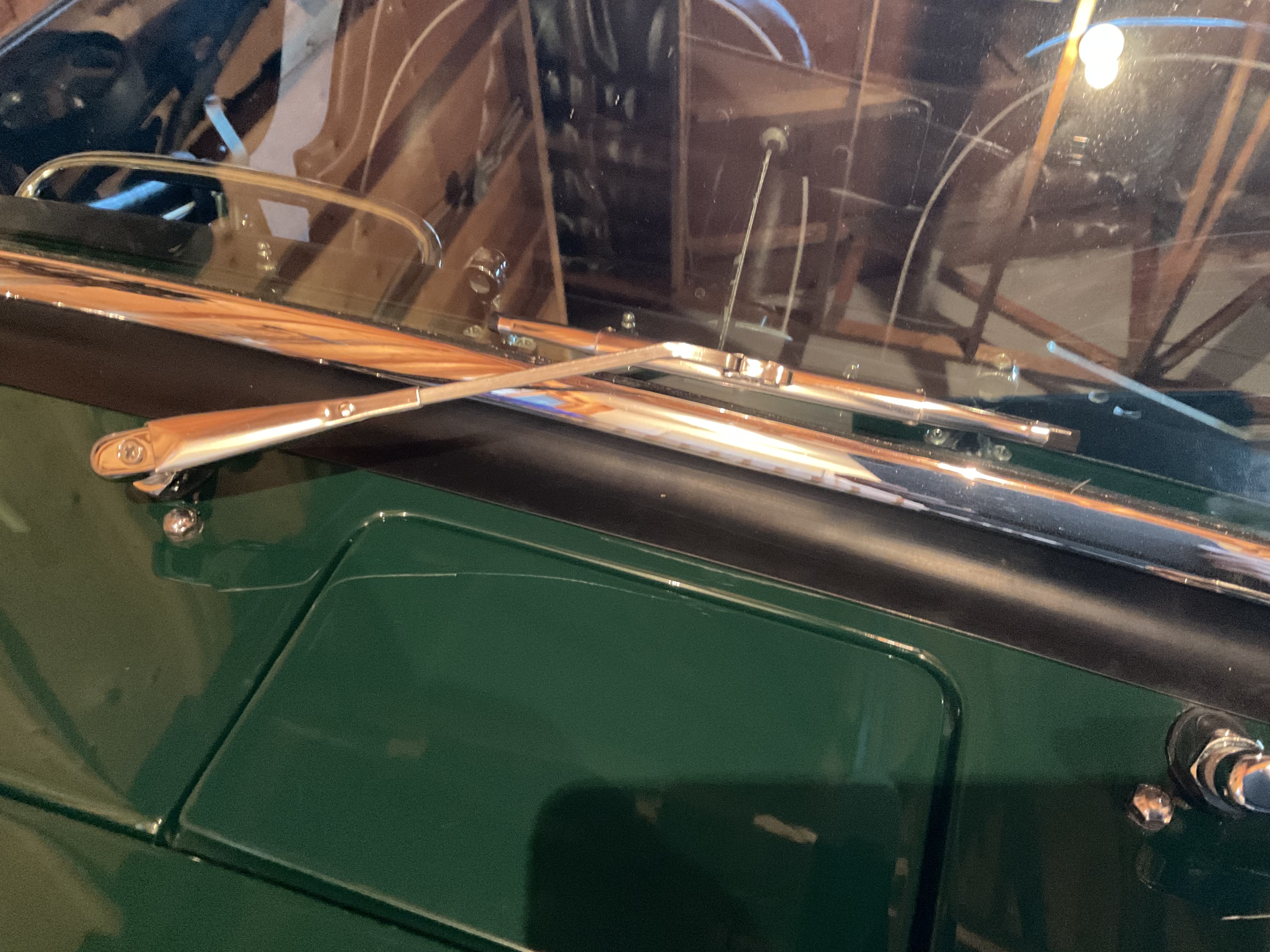

I replaced my TR3A wiper wheels boxes a couple of years back and like you bought them on eBay. The splines on the old ones were worn and arms were falling off. Installed new wheel boxes but the splined shaft seemed smaller than the original not larger. Old arms would not stay on. Went to the dark side and bought Midget arms at Moss, part number 164-610. If you are not doing concours, this may help. There is a set screw to adjust and tighten the arms on the shaft. It worked for me and I now have flex blades instead of the rigid ones too.

Yes it clamps onto the shaft. There is a small wedge inside the collar into which that set screw goes. As you tighten the set screw it pulls up the wedge to effect the clamping process. The only draw back with these arms is that they will not flip up off the glass into a vertical position. You can lift them up but not all the way and they will not stay off the glass. I can live with that. Hope that helps.
