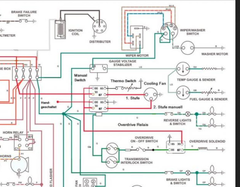

this is about the best diagram i can find showing the wiper circuit
if yo look at the diagram, the right hand fuse is power to the wiper. green wire goes straight to the motor plug.
this should be live when ignition is tuned on.
the other green feed many other items including the power to the wiper switch.
if everything else including wipers is working, then the fuse is good.
check there is 12 volts at the wiper end of the green wire,
if you have voltage then there is a problem inside the wiper motor.
