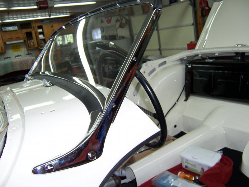

The nylon washers are still available from Moss, part # 315-168, ten to a pack. Bought them over 20 years ago and again recently under same part number. Below is a shot of my windscreen using them under the studs. You might just be able to see some of the closest ones. Also got some of the leather washers thinking they might be good for studs on the painted areas.
