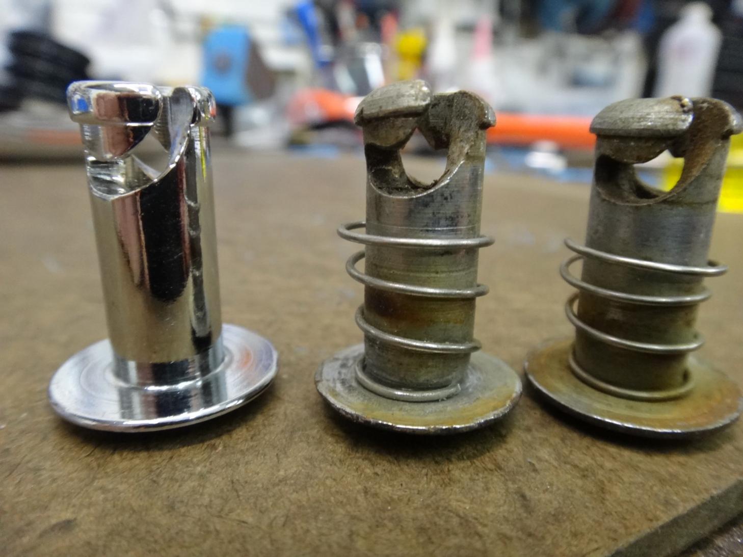

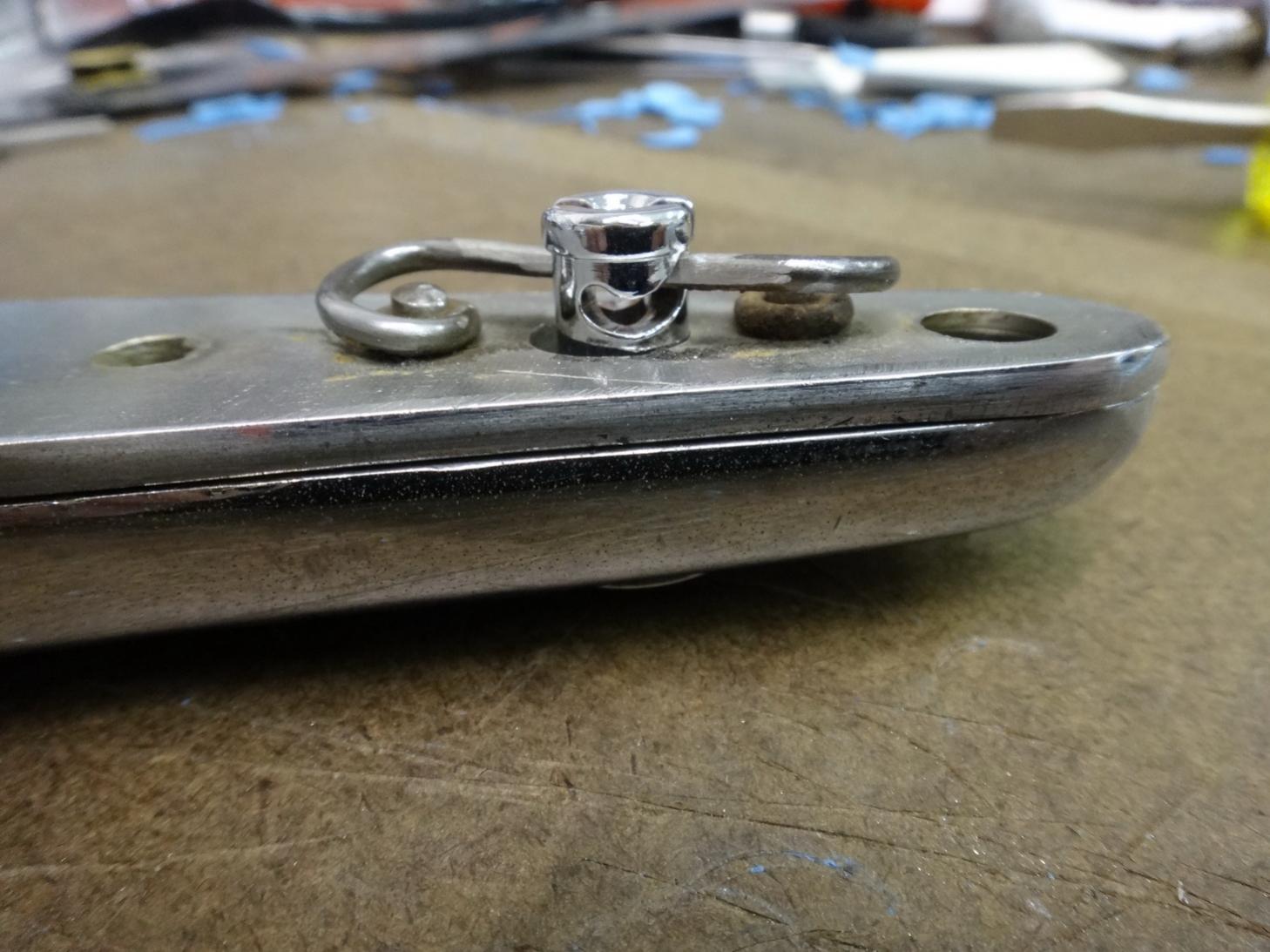

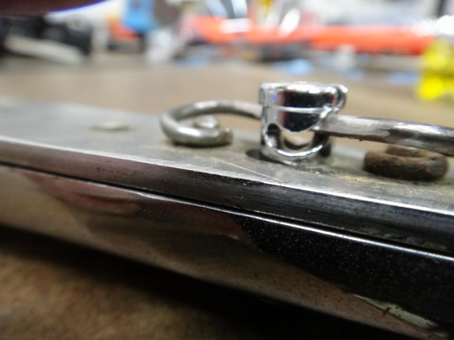

I'm restoring a 59 TR-3A pre-60k and am in the process of installing the windscreen stanchion and guide plate. The problem I've run into has to do with the new Dzus fasteners I bought from Moss. The basic dimension is the same as the old ones, but the gap that makes the connection with the wire on the guide is too narrow. No way will it tighten up as it is. I called Moss tech support and they say that's the only part they list. No alternatives. It appears that I'm going to have to take some files to open the gap. Here's a photo to show the difference between the new one and the original. You can see that the old one was opened up, AND deformed.
I guess my question is, has anyone else had this problem, or have you heard of it? The Moss tech checked the feedback he had on this part but couldn't find any prior reports of this issue. Any suggestions other than modifying the gap?
