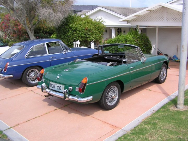

I,ve enclosed a photo of my 2 girls for you
