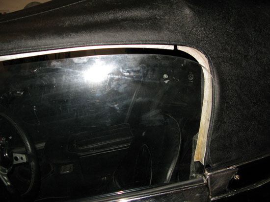

After getting a top installed on my BJ-7 the windows when closed do not fit the top frame bows but protrude over the wooden sections at the top by about 3/4". Thus protruding horizontally past the top. Thus allowing water to enter from the top of the window.

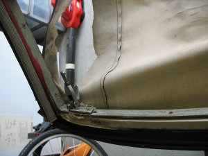

Robert, you're missing the "U" shaped cloth/rubber pieces that fit over the aluminum side and top of each window. Here's a photo of mine before I added a new top.

I know I'm missing those but they wouldn't make it fit any better than it does. I'm thinking it might be a result of frame sag. Any ideas?
The vent window frame is right up against the windshield frame so there is nowhere to go in that direction. I already had to adjust the window frame at bottom to get it to fit at that point.
That would be pretty severe frame sag!
Place a jack under the middle of the chassis (board between jack & chassis) and see if the window goes into place.
I'm betting the it doesn't, because if the frame was that bad, you'd surely notice it going down the road.

1) I tried jacking up the frame and the window almost clears the back weather strip aluminum channel but it also makes it impossible to latch my top. I removed the striker and pushed in on the door but the window wont get any closer than approx 1" the channel flange the weather strip attaches to. And the door is right up against the rear weather strip channel so it can't go any farther in. Also there is a gap of over an inch from the top of the glass to the top, plus the glass is not overhung by the top so water will pour in if it rains.
