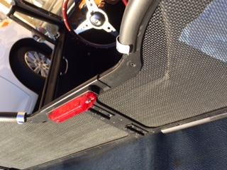

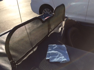

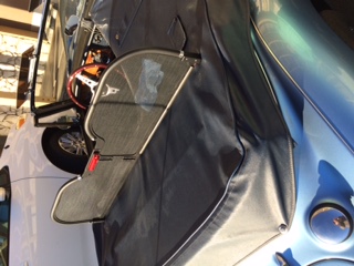

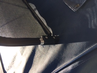

Here are some images of a home made one I captured at one of our Oregon meets. Quite clever, as it bifolds, and the clip that holds it straight when in use also serves as a third brake light:

That is a nice implementation. How is the unit anchored? I see the top part of the vertical but not how it attached to a supporting Healey structure. Is the tonneau cover in the picture the standard one for BJ8s or a modification?

I talked to the guy briefly, but I believe it has two posts which tie into the hoop that goes from side to side supporting the tonneau cover. The cover looked standard to me, he just cut holes to fit in the shield and added those flaps in front, but I cannot recall what they were for, Sorry. That is foam tubing slit on one side slipped over the frame edges. Its cut out of aluminum plate, 1/8 thick IIRC, and sandwiches the mesh which he had gotten locally, home depot or some place like that. The hinges look a little off, but otherwise nice fit and finish. jerry
